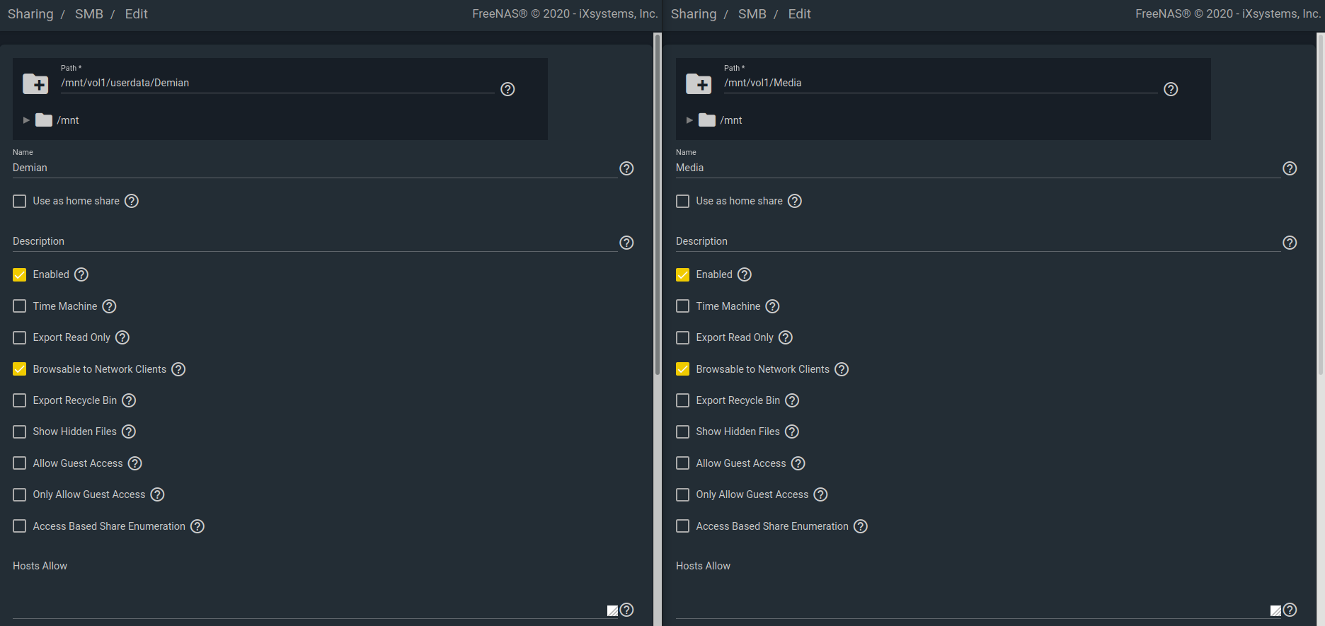

Media is the only share, that is correctly mounting. But permissions and owner are identical, share settings as well. So why s one working and the other (all others for that matter) aren't?

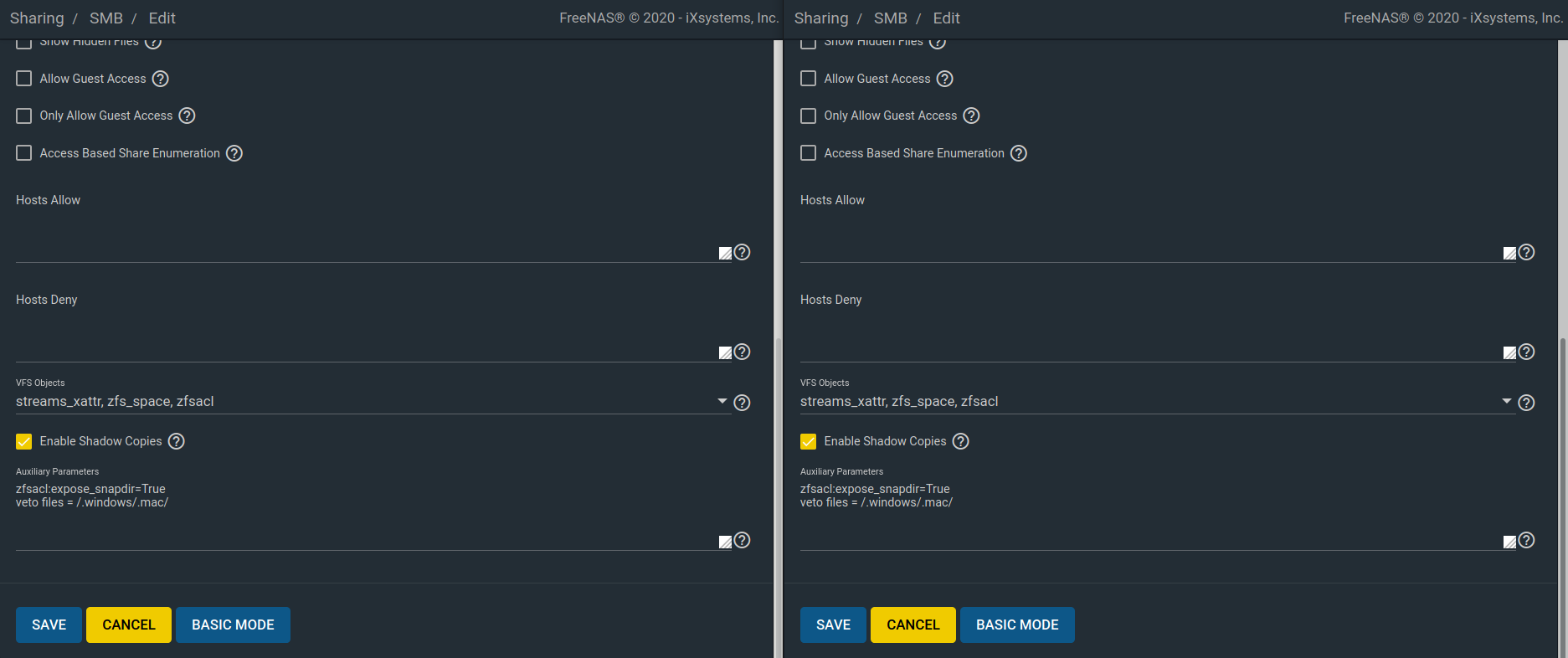

All user datasets get the permission denied error on the Linux notebook. Similar errors are found on a Windows machine and on my AndSMB app on my phone, so the client shouldn't be the problem. And the really weird part is, that this problem started out of nothing (2 weeks ago). I upgraded from 11.3-RELEASE to 11.3-U3.1 end of May, and after the permission problem started to U4.1, which didn't change anything.
I have created new shares on existing datasets, new datasets, setting ACL's on the test datasets but no luck.
Any ideas from you guys? Would appreciate any help, since I can't properly access my data except through nextcloud.
