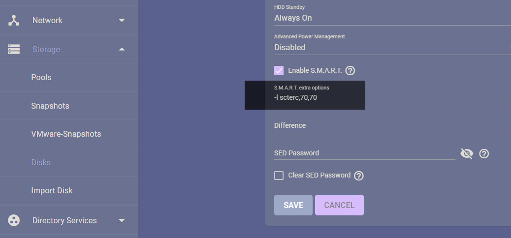

A few days ago I shucked two WD Elements and got two WD80EDAZ-11TA3A0. They respond to "smartctl -l scterc,70,70 /dev/adaX", and set TLER. But, they don't retain it after power off and on. Is there anything that can be done about that?
Oct 22, 2019
3,641
Storage > Disks > locate the drive in question > Edit > S.M.A.R.T. extra options
Add this line in the above text field:
-l scterc,70,70

Perfect. Thanks for the help.

I just logged in to report my experience trying to get my shucked WD80-EZAZ retain the TLER settings after a power cycle. I was going to suggest this solution as an alternative to the script posted in this thread.
So far this method works for me in a very reliable way. I'm all up to using scripts to do something that the OS doesn't do out of the box but in this case truenas has a native method of implementing my intent.
I honestly feel like I'm missing something. Am i giving up something by using this method instead of sing the script?
