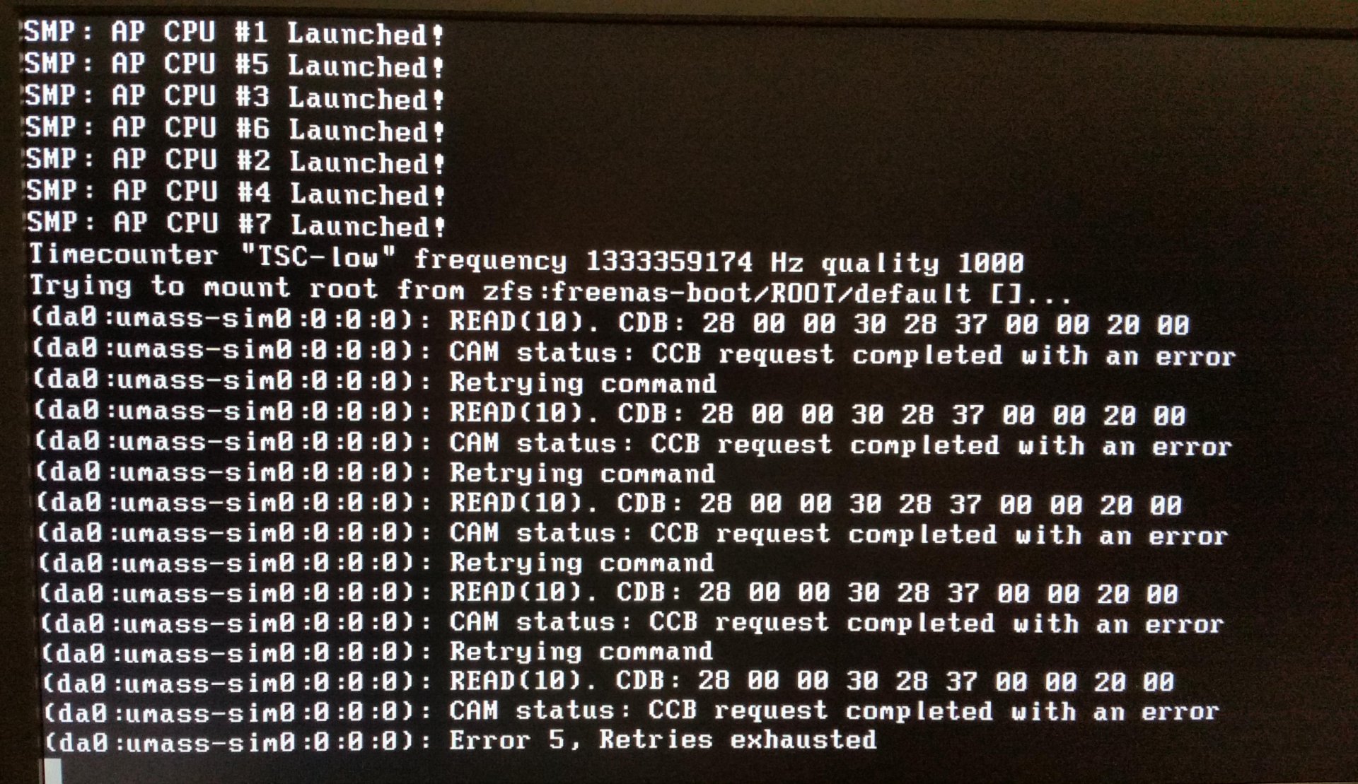

My FreeNAS 9.3 was running fine on an 64bit, booting from an internal USB drive with three HDDs @ 500Gb each (= 1Tb storage). Now, I get this on boot (see attached pic). What do I do now? Did I lose a HDD or is the USB drive messed up? Which device is da0? If I am to boot from a DVD to fix the USB drive, which one do I use (the installer does not seem to be the right choice)? Your help would be greatly appreciated. I can do the work, but I need someone to just point me in the right direction. Thanks in advance.

Boot device is probably toast. Reinstall FreeNAS to new media and restore your config.

Thank you very much. That was it. I got a new USB and created a bootable with 9.3 STABLE.

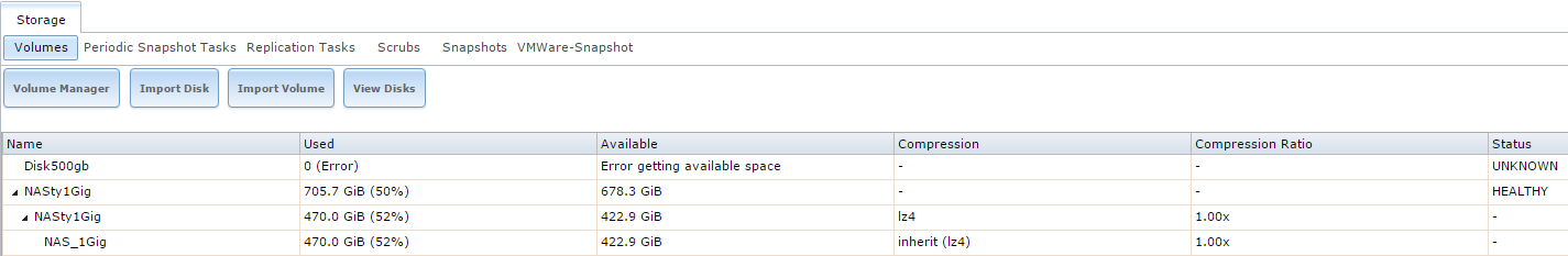

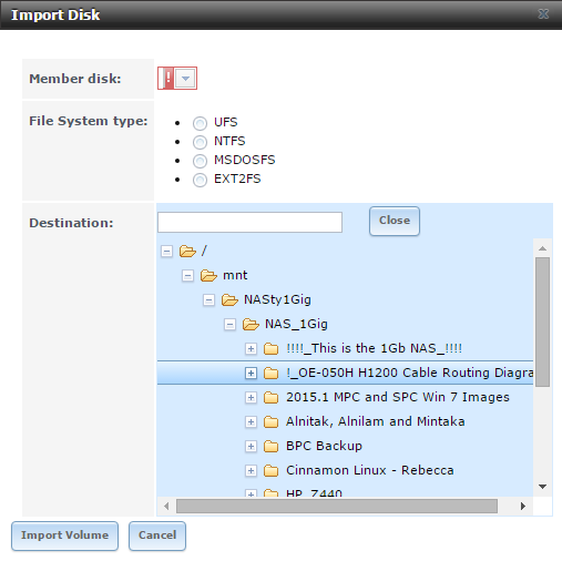

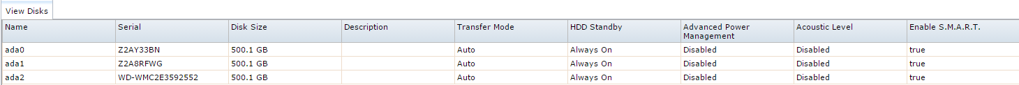

Thanks. Tried that, but cannot get this to work. All three drives are up:
...but I have something set wrong; no imports work.
I guess that is what you get when a noob sets it up. It sees the directories, but won't let me import. Nowhere does it refer to the volumes as ZDS. What am I doing wrong?

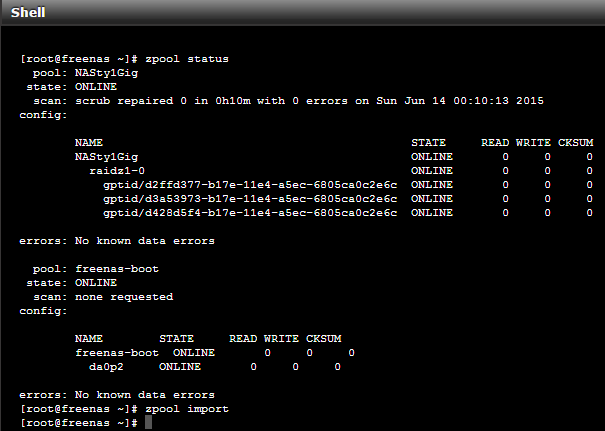

Not import disk. Import pool - but it seems to be imported already.
What's the output of zpool status and zpool import?
cldavis58
Jan 14, 2015
11
Thanks for the help...
zpool import only gives me a short delay, then returns to the prompt...
Well, your pool is present, nothing wrong there.
You'll just have to reconfigure your shares and stuff. Data is all safely there. (Well, as safely as RAIDZ1 can store it, but that's a different topic).
