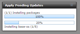

FINAL UPDATE: Ok, in the end, the upgrade succeeded! But it was VERY slow compared to other upgrades, and I'm not sure why. So for those of you stuck at 20%, open a terminal and "zfs list" and check to see if there is a U3 boot environment that is growing in size, and if so, just let it sit and complete (it could take a couple hours).
UPDATE: I opened a terminal and did a "zfs list" and I can see the "freenas-boot/ROOT/9.10.2-U3" boot environment and the "used" space is going up, so clearly it is installing something, but it is VERY VERY slow. I have done many updates before, but for some reason this one is painfully slow, unlike the updates in the past. I'm not sure why. But I'll let it run to completion and report back.

I'm seeing the exactly same thing. Upgrading from 9.10.2-U2 to U3. I have 3.5GB of free space on the USB stick. I'm using two 8GB USB sticks in a mirror for my boot device. It's just been sitting there for an hour now stuck at 20%. See screenshot.
Yup I'm aware that it can take a long time, but 36rhs seems to be a bit to long even for an upgrade :D Oh and I can't SSH in to my server either so no way of checking!
