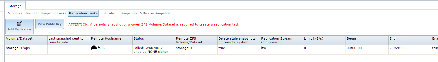

Hello,
See my signature for hardware specs.
I know there have been a lot of issues recently with replication, I checked out all the bug reports and did a forum search before posting this. I had Replication working great until I upgraded to the latest version and now nothing I do will re-establish it. My problem seems related to this but I'm not 100% sure https://bugs.freenas.org/issues/11847, maybe someone can advise me on running the patch or not based on my screenshots / description.
Based on my research "NONE cipher" as an error is a GUI bug, other than that nothing is complaining. It just keeps re-running the replication send command but nothing shows up on the other side.
Also I think this is as designed but I had to create the dataset instead of having it created by replication on the Pull side.
Cliffnotes:
- Push and Pull sides are both the latest FreeNAS-9.3-STABLE-201509282017
- Push and Pull both freshly rebooted
- I have a full set of snapshots on Push side completed
- There are no holds on replication on Push side
- Pull side volume has been completely recreated (no snapshots / data)
- Push side tries sending initial replication every minute but never starts

Can anyone shed light on this? Should I submit a bug?

Did you get any farther with this? If not, please submit a bug and post the issue number here.

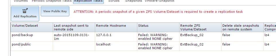

Build FreeNAS-9.3-STABLE-201511040813, hardware in sig
I have the same issue, unable to replicate to a local drive with Encryption Cipher set to "Disabled". It does replicate if I set the cipher to "Fast". The below image has the error in the status, the second one was still running at screenshot time. The status for both changed to "Up to date" after finishing.
