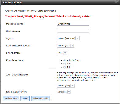

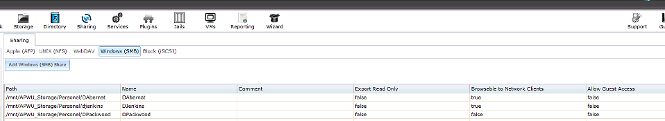

I can't find information on how to delete an item from the mounted Sharing drive, and when I try to add it to the Pool, I get an error that it already exists. I have tried to delete it from the Sharing SMB, but it doesn't delete. I reloaded my config file from before I screwed up and put mounted it before I put it in the pool, but it's still there. Here are a couple of captures to see what I'm saying. Any Help would be great, Thanks.

Are you trying to remove the share or the dataset? In either case, click the line you want to remove and you will see a button at the bottom of the screen - a red X if I remember right. Removing a share is non-destructive, removing a dataset will destroy the data. You are warned.

I am trying to create the dataset in the pool, but I forgot and got ahead of myself and added it to the share first, now when I try to add it to the dataset, I get the error "The path /mnt/....... already exists". Is there some way to unmount the share. even when I click on the "Delete" in Sharing it does not unmount the share, and I don't see anything it "Edit" that will allow it either. Unless it is unmounted I can't use the same information for the dataset in Storage to create a dataset in the file pool. Is there a command set in Shell that allows the Sharing path to be unmounted or deleted?

I was not able to delete the mounting points, but I was able to work around it by creating a new pool dataset and assigning it the username i wanted to the new dataset.
