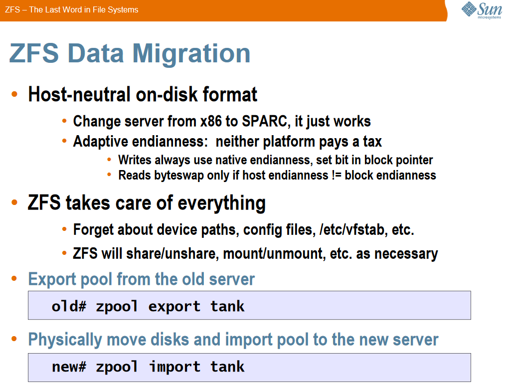

But that said (and from a position of admitted ignorance) I'd expect this level of portability to be a matter of how the fundamental data structures are laid out on disk in terms of size, endianness, padding, etc. And I wouldn't expect those to change in a hurry. It would be surprising and disappointing to find OpenZFS developers had blithely broken such a level of (in-principle) platform independence.
Well, I was more putting it out there for everyone than trying to tell you. I figured you might be aware.
Many of the developers departed Sun when Oracle took over and are still working on the OpenZFS project from their new places of employment.
I am not aware of OpenZFS working on non-x86 anywhere though.
I have not heard of one, but I agree that the way data is put on disk is intended to be hardware agnostic for the very purpose of being able to move the drives, with data, to a different platform because Sun had the Spark processor and moved to the x86 and they probably wanted to keep their options open for moving to the next platform later. They envisioned ZFS as being the last file-system that would ever need to exist.
https://www.cs.utexas.edu/~dahlin/Classes/GradOS/papers/zfs_lc_preso.pdf
