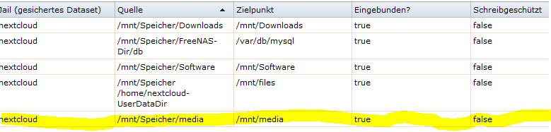

Hello,
I have a jail "nextcloud". It contains some mountpoints and they are all working as expected, but one.
The highlighted one can be accessed, read, but all Subfolders are shown empty. I do have r/w permissions.
/mnt/Speicher/media is a Dataset which contains more Datasets.
/mnt/Speicher/media/Bilder
/mnt/Speicher/media/Downloads
/mnt/Speicher/media/E-Books ....and some more.

I have recreated the mountpoint serveral times, quadruple chequed the permissions but I cant get this one running.
As Mentioned, Speicher/Downloads /Speicher/Software and /Speicher/media are shared via NFS and Samba, the other two Paths are working fine. From Jail, Samba and Console (havent tested NFS jet).
/Speicher/Software contains an other Dataset as well, but this works fine too.
I have read that shared folders are not supposed to mount into jail. I am willing to change this, but even mounting the Datasets contained in /Speicher/media directly into the jail does not work. Their content is not listed.
