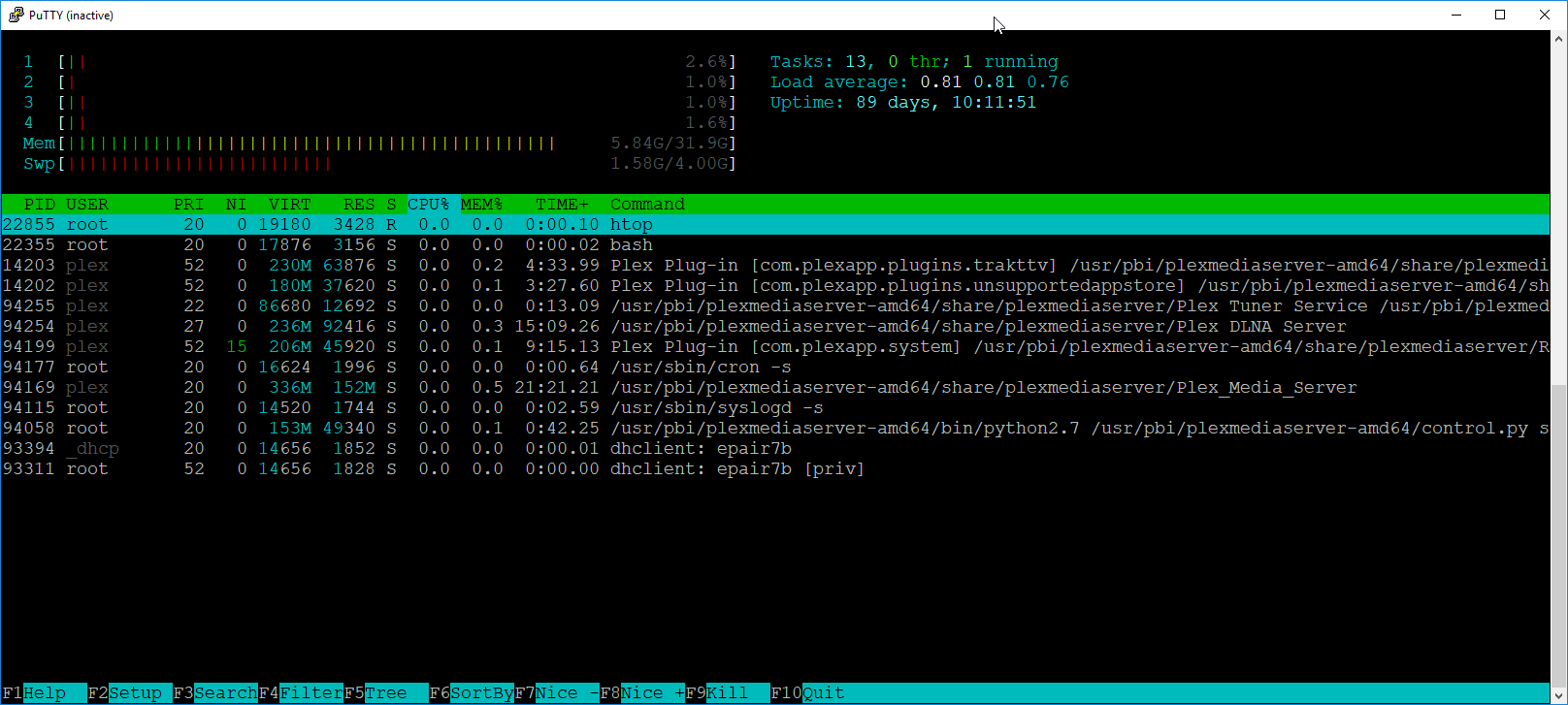

I updated Plex via PMS_Updater.sh a couple of days ago but since then I can't access Plex anymore.
Plex seem to be running:
[root@plexmediaserver_1 /]# service plexmediaserver status
plexmediaserver is running as pid 94169.
But I can't access it directly on it's IP nor via the plex.tv website.
I reinstalled an older Version back and forth with the Updater-script, but still no access.
Has anyone an idea what to do?

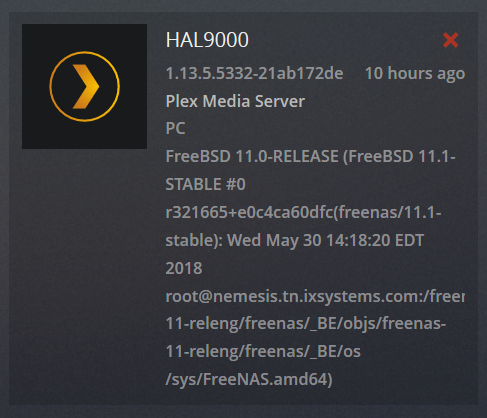

Interesting: I just saw in the Devices Tab at plex.tv that there was a contact from plex.tv to the Server ("10 hours ago") which must be at the time when my ISP forcefully Disconnects my Internet-Connection. So it seems to me that there is more of a Network Problem then a problem with the Plex Server itself.
But, how to fix it?
