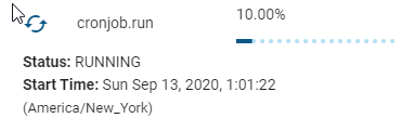

Hey all,
I currently have a strange issue when it comes to running a cron task that executes a basic script that restarts a few services within a couple of jails.
This is the command for the script:
/mnt/Production/Homes/alpha/restart-deluge.sh
And the script itself:
#!/bin/sh
jexec ioc-deluge /usr/sbin/service openvpn restart
sleep 10
jexec ioc-deluge /usr/sbin/service deluged restart
sleep 10
jexec ioc-deluge_web /usr/sbin/service deluge_web restart
I don't think I am missing anything here but whenever the cron job executes it just hangs indefinitely until I run the script manually. When I run the script manually everything executes just fine. I'm running the script as the root user. Any ideas why this is having such a weird issue?

The permissions look okay on the script. I went ahead and tried the cron job with sh and have the same issue. It isn't a permissions issue. The cronjob just hangs until I run the script from command line.
