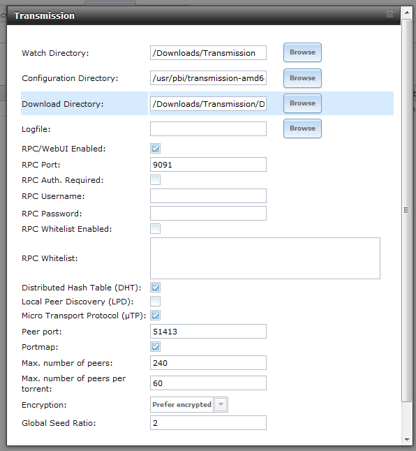

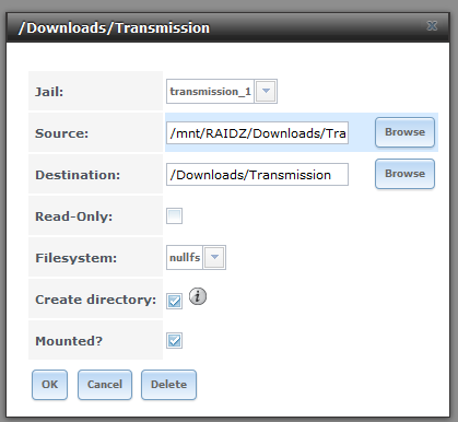

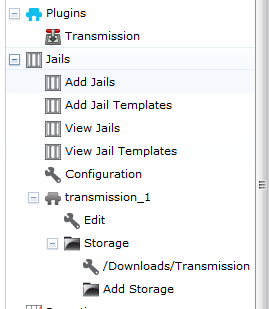

I've updated to FreeNAS v9.2, and just finished setting up Transmission as shown in http://forums.freenas.org/index.php...couchpotato-sickbeard-and-transmission.19043/ but still have a similar problem as before. Transmission does auto-load the torrents that I put in the Downloads\Transmission directory but I cannot delete or modify the data that Transmission downloads to Downloads\Transmission\Downloaded. I did not install Plex, Couchpotato or Sickbeard and the only things I did differently with the Transmission setup were:
1. I used an existing "Transmission" user and group (I assume I created these for Transmission on v8) instead of "media" and did not create a guest user.
2. I gave the Transmission user and group rights using chown -R Transmission:Transmission /mnt/RAIDZ/Downloads/Transmission
3. I did not do the last line in the separate Transmission setup section because I didn't see the unmask property, there was "umask": 18, but I wasn't sure if that was what I wanted so I just exited the editor
The user I'm accessing the data in Downloads\Transmission\Downloaded is in the Transmission group.
Some screenshots of my config are attached. Obviously I'm missing something but I'm not sure what. Please help...

I have it working now but on the dataset containing the source for the mount point I had to set the owner to 'nobody', the group to 'nogroup' and give full rights to the owner, group and world. Ideally what I'd like is for only my user to be able to modify the data that has been downloaded by Transmission, but if I change the owner or group from 'nobody' or 'nogroup' respectively and remove world access Transmission doesn't autoload torrents.
I just don't understand how the permissions work, which user is Transmission using to download the data?
