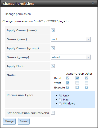

I have been running freenas from early ver 7 days and always found it to be rock solid through all the upgrades even with the latest iteration to 9.3. I was running mediabrowser quite successfully until I installed the upgrade "FreeNAS-9.3-STABLE-201505010007". After that mediabrowser refused to start with a system error that said the jail was "worldwritable" and refused to start. After reading through some threads it was pointed out that there could be an issue with ownership and execution permissions. I adjusted all the permissions to default 755 that did not seem to make a difference. I decided to delete that jail and recreate it. I tried to install the plugin from the gui and after downloading the plugin it errored out saying that it could not find a template. I manually installed all the templates that I could lay my hands on for both 9.2 and 9.3 and tried to create a jail from the gui. That did not work same error. In desperation I tried to create a jail from the CLI and captured the process see below. I analyzed some of the output and it seemed that there might might be a routing or DNS problem because it could not find some files that the script was calling. So ran:
