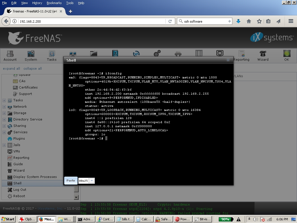

Yep, it's the 82571EB that I have...output of ifconfig is attached...can you see it?
No other cards in the system. All I've done since installing FreeNAS was to make the sure all the drives showed OK and defined the volume.
I notice on the ifconfig that I'm running at half-duplex BTW...how to I set this to full-duplex? And is there a way to run commands in the shell and output to a file...guess that would make for easier reading and uploading here, etc.

Please post the output of pciconf -lv | grep -B4 ethernet. Text inside [code][/nocode] tags is preferred to screen captures. Please also identify the version of FreeNAS being used.
Half-duplex often means a duplex mismatch due to a low-quality Ethernet switch.
Interesting...it's a simple Netgear 4 port switch I have about while the NAS is on the workbench. Didn't give me problems up to now, but ok.
Thanks.
