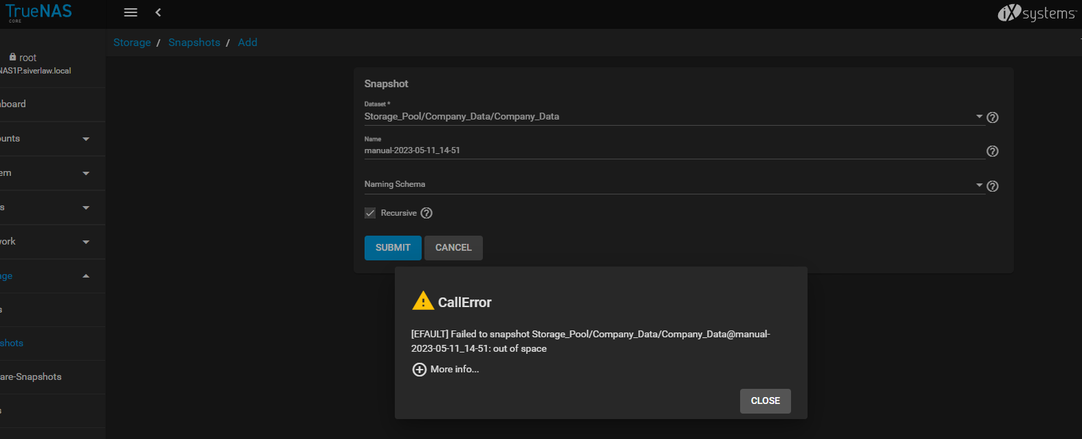

I am new to TrueNAS Core, and have spent the last couple of days on the forums and YouTube to try and solve this issue. I do not know what I may be missing and need a little help.
Error: concurrent.futures.process._RemoteTraceback:
  File "/usr/local/lib/python3.9/site-packages/middlewared/plugins/zfs.py", line 1019, in do_create
    ds.properties['freenas:vmsynced'] = libzfs.ZFSUserProperty('Y')
  File "libzfs.pyx", line 402, in libzfs.ZFS.__exit__
  File "/usr/local/lib/python3.9/site-packages/middlewared/plugins/zfs.py", line 1016, in do_create
    ds.snapshot(f'{dataset}@{name}', recursive=recursive, fsopts=properties)
  File "libzfs.pyx", line 3798, in libzfs.ZFSDataset.snapshot
libzfs.ZFSException: out of space
  File "/usr/local/lib/python3.9/concurrent/futures/process.py", line 246, in _process_worker
    r = call_item.fn(*call_item.args, **call_item.kwargs)
  File "/usr/local/lib/python3.9/site-packages/middlewared/worker.py", line 111, in main_worker
    res = MIDDLEWARE._run(*call_args)
  File "/usr/local/lib/python3.9/site-packages/middlewared/worker.py", line 45, in _run
    return self._call(name, serviceobj, methodobj, args, job=job)
  File "/usr/local/lib/python3.9/site-packages/middlewared/worker.py", line 39, in _call
    return methodobj(*params)
  File "/usr/local/lib/python3.9/site-packages/middlewared/schema.py", line 979, in nf
    return f(*args, **kwargs)
  File "/usr/local/lib/python3.9/site-packages/middlewared/plugins/zfs.py", line 1024, in do_create
    raise CallError(f'Failed to snapshot {dataset}@{name}: {err}')
middlewared.service_exception.CallError: [EFAULT] Failed to snapshot Storage_Pool/Company_Data/Company_Data@manual-2023-05-11_14-51: out of space
The above exception was the direct cause of the following exception:
  File "/usr/local/lib/python3.9/site-packages/middlewared/main.py", line 139, in call_method
    result = await self.middleware._call(message['method'], serviceobj, methodobj, params, app=self)
  File "/usr/local/lib/python3.9/site-packages/middlewared/main.py", line 1236, in _call
  File "/usr/local/lib/python3.9/site-packages/middlewared/service.py", line 496, in create
    rv = await self.middleware._call(
  File "/usr/local/lib/python3.9/site-packages/middlewared/main.py", line 1244, in _call
    return await self._call_worker(name, *prepared_call.args)
  File "/usr/local/lib/python3.9/site-packages/middlewared/main.py", line 1250, in _call_worker
    return await self.run_in_proc(main_worker, name, args, job)
  File "/usr/local/lib/python3.9/site-packages/middlewared/main.py", line 1169, in run_in_proc
    return await self.run_in_executor(self.__procpool, method, *args, **kwargs)
  File "/usr/local/lib/python3.9/site-packages/middlewared/main.py", line 1152, in run_in_executor

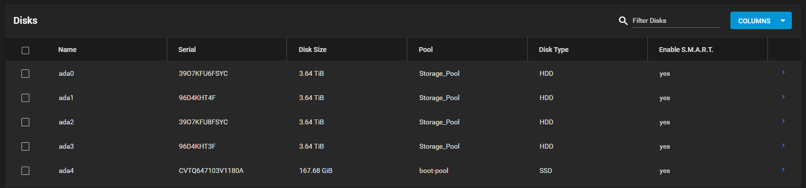

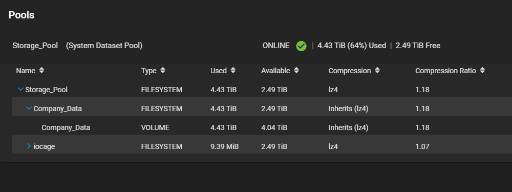

NugentS
Apr 16, 2020
2,947

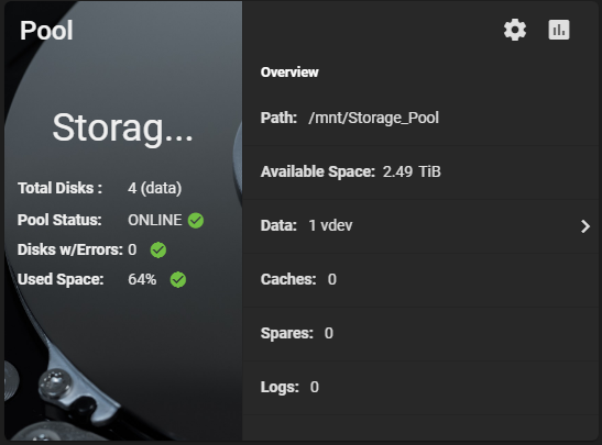

Well I would say you have run out of disk space. What makes you think it isn't that?
Look at the dashboard - the Pool widgit.
Or
Storage/Pools and post a screenshot of what you see there

Is Company_Data a zvol or a dataset? That distinction matters when you're taking a snapshot.
Whattteva
Mar 5, 2013
1,824
AHA! That's your problem. You're trying to take a snapshot of a 4 TiB zvol with only 2.49 TiB space left.
Yes I know, snapshots are supposed to be lightweight, but zvols are an exception unfortunately.
Basically, if you do a zfs list Storage_Pool/Company_Data/Company_Data you might get something like this:
NAME                          USED  AVAIL     REFER  MOUNTPOINT
Storage_Pool/Company_Data/Company_Data  4.43T   <some_amount>    4.04T  -
In order for that zvol to be snapshottable, you must have more space available than what's listed in the REFER section.
mahmud100
May 11, 2023
6
Thanks, I will have to upgrade the disk set.
