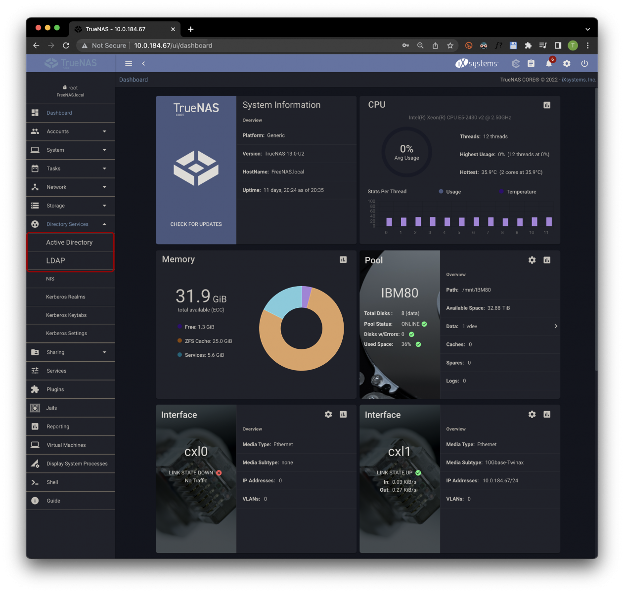

Are you considering running TrueNAS as an AD/LDAP server? Because I don't believe it supports that at all. You could, of course, install Windows Server (or Univention Corporate Server, or Nethserver, or Zentyal, or probably other software) in a VM and use that for AD. Or you could install OpenLDAP (or whatever other provider you wanted) in a jail in CORE. Or you use the TrueCharts app for OpenLDAP in SCALE.
As to some of your other points: Obvously TrueNAS (CORE or SCALE) can handle acting as a NAS--that's kind of what it was built to do. But nether Linux nor FreeBSD run Hyper-V, so that would be out. I have no idea what you mean by "RAID Performance (speed) using AD", as those sound like two completely unrelated things. Linux and FreeBSD are far less vulnerable to viruses and malware than Windows, both because there's less interest in writing malware for them, and because their respective permission systems limit the impact of any such software. A sensible snapshot schedule (and backups, naturally) should greatly reduce your exposure here.

Shit. Looking at your info here, I HAVE to assume you know what you're talking about ... but they say how to set up AD ... but I know so little about AD that maybe I'm confusing workstation with server..?

In very broad terms, TrueNAS is a NAS appliance. It provides network storage (either file-based, or block). AD / LDAP comes into the picture in terms of basically single-sign-on ability for file-based storage.
When we join AD for instance, AD users and groups can be used to authenticate to SMB shares (or NFS), and the users and groups are also visible in the permissions editors.
Being an actual domain controller or LDAP server is a different sort of role. TrueNAS doesn't do this. Although some users decide to host their DCs as VMs on TrueNAS and then join the TrueNAS server to the VMs that are running on it, this sort of configuration is not supported due to the logical / configuration loop involved.
15,504
That section of the docs is about joining TrueNAS to an existing AD domain, not about TrueNAS acting as a Domain Controller--as you've since found. Earlier versions of FreeNAS--through around 11.2--could act as a Domain Controller, but that feature has since been removed. Since I never used that service, I didn't pay much attention to the reasons; maybe @anodos or someone else can fill in on that.
But as I said, there are at least three other pieces of software than can act as a Domain Controller, other than Windows Server. Any of them (or Windows Server) could run as a VM, either under TrueNAS (SCALE would be better than CORE for this) or some other hypervisor, and then TrueNAS could connect to that system.
