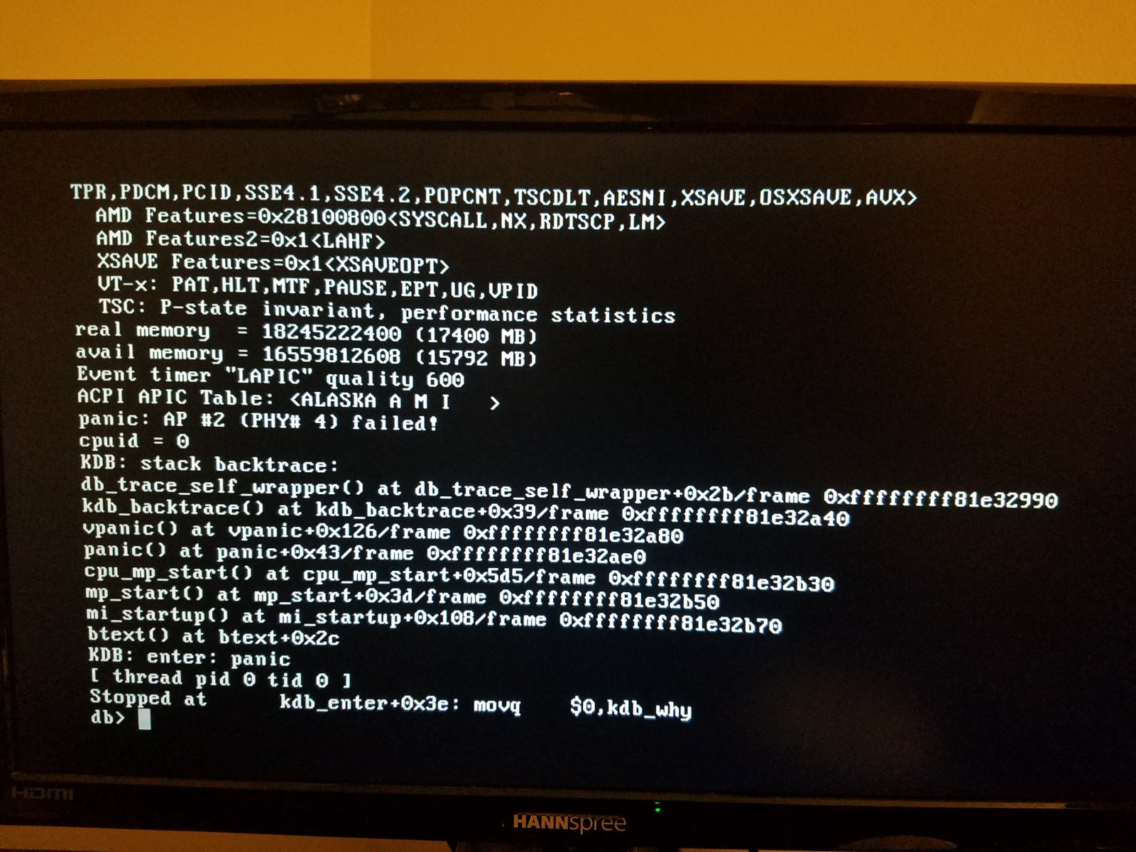

So I recently built a new rig just to be a media server.. I've played with FreeNAS before on my other two systems with no problems. but when I tried to install it on the new system. this happened.. can somebody explain what this means? I'm lost..

Hardware? FreeNAS version? Other information that the forum rules (which you said you read and agreed to when you registered today) require?

Some kind of hardware failure or unsupported hardware. Fix your hardware.

I'm using the most current version of FreeNAS I have 16 gigs of RAM using I5 2500 k it works and installed on my i7 2600 k no problem

So I turned off all my cores except one and it worked why is that?

Is your CPU overclocked?

It kind of looks like you have 17G of RAM. Which implies mismatched memory to me, so I'd remove the littler one and try again.

I have 4 2 gig sticks two different brands I've tried every combination

It seems that it doesn't like my CPU I can get it to work if I only used one core.. anything more then one Core it doesn't boot..

The SuperMicro docs I've looked at lately are very specific about not mixing different sizes or even models of memory.
(Certainly they were not specific about what I really did need to find out, but they were specific about memory.)
