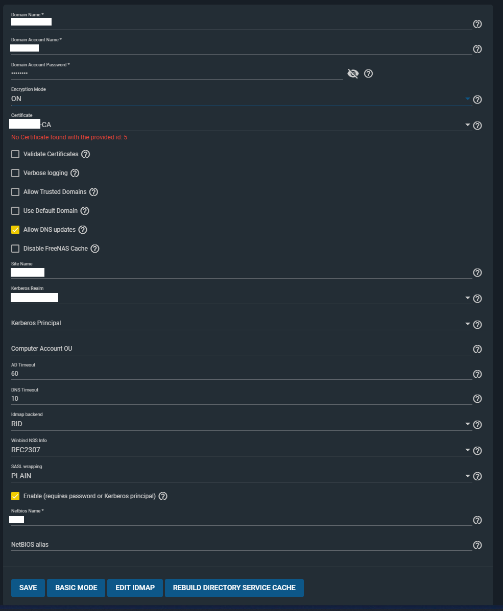

I had previously configured AD and imported the CA cert from my domain controller. Everything was working up until I upgraded to 11.2. Since the upgrade, I am getting alert stating that AD connectivity has faulted. When I go and try to reconfigure the settings, it starts complaining about the root CA certificate. Do I went and deleted the cert and re-imported it. That seemed to have made it even worse. Now when I go and re-configure AD and selecting the cert, it says the cert cannot be found.

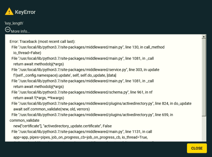

I have the also some strange issues like eroji.
But for me I simply got a KeyError:
Inside this error Message stands:
And it is reagardless if I deselect the cert or not.
  File "/usr/local/lib/python3.7/site-packages/middlewared/main.py", line 130, in call_method
    io_thread=False)
  File "/usr/local/lib/python3.7/site-packages/middlewared/main.py", line 1081, in _call
    return await methodobj(*args)
  File "/usr/local/lib/python3.7/site-packages/middlewared/service.py", line 303, in update
    f'{self._config.namespace}.update', self, self.do_update, [data]
  File "/usr/local/lib/python3.7/site-packages/middlewared/schema.py", line 961, in nf
  File "/usr/local/lib/python3.7/site-packages/middlewared/plugins/activedirectory.py", line 824, in do_update
    await self.common_validate(new, old, verrors)
  File "/usr/local/lib/python3.7/site-packages/middlewared/plugins/activedirectory.py", line 659, in common_validate
    new["certificate"], "activedirectory_update.certificate", False
  File "/usr/local/lib/python3.7/site-packages/middlewared/main.py", line 1131, in call
    app=app, pipes=pipes, job_on_progress_cb=job_on_progress_cb, io_thread=True,
  File "/usr/local/lib/python3.7/site-packages/middlewared/plugins/crypto.py", line 855, in cert_services_validation
    if not cert['key_length']:
KeyError: 'key_length'

Right. That bug will be fixed in U3. Try the following midclt call activedirectory.update '{"certificate": null}'
