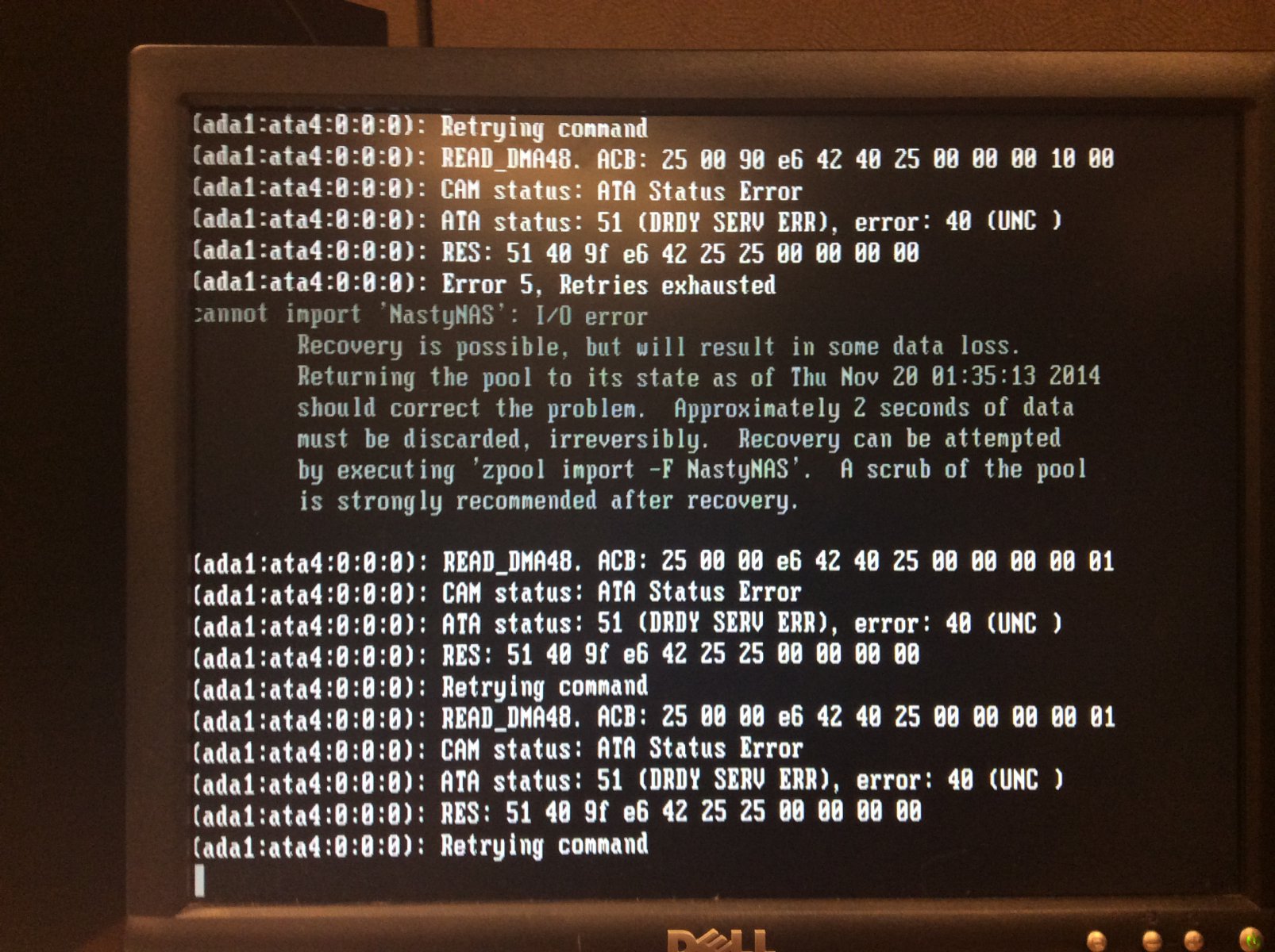

Hey guys im pretty new to the forum and am having some trouble with a nas i built. The nas was up and running for a about 6 months. Mounted the drives created permissions etc etc etc. I was away from my HQ for some time upon which i decided to look for some files and noticed my drive was no longer mounted. I then tried to connect to the webgui and it was not found either. I plugged in a keyboard mouse and monitor into the box and began to troubleshoot. The first thing i notice is that upon allowing it boot all the way is that it comes up with a "bus error" in addition it tells me that it cannot import "NastyNAS': I/O error. It then tells me to run zpool import -F NastyNAS although im not sure where i can run that command to begin recovery. I have attached a video of the device booting in addition to a few screen shots. Any help or suggestions is much appreciated i have 10yrs of my kids pics on here. Thanks in advance
Also here are my specs:
7gb Memory
Intel Pentium Dual Core E52002.50Ghz
5x 3.5 hard disks configured for Raid (not sure which) on the ZFS format
1x usb drive that i booted free nas from for initial install

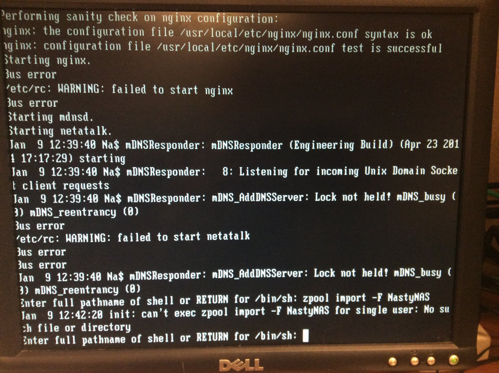

That's exactly what i have been trying to figure out, how do i run a shell command? i have attempted to boot to single user mode, it eventually got me to a point that i actually have a cursor and can run a command. I have tried to run the zpool -F NastyNAS command however i receive an error stating that no such directory exists. Not sure if im even in the right place. As for checking my bus im not sure what you are referring to, on the motherboard? The sata connections on all 4 disk drives are firmly seated both at the motherboard and drive ends.

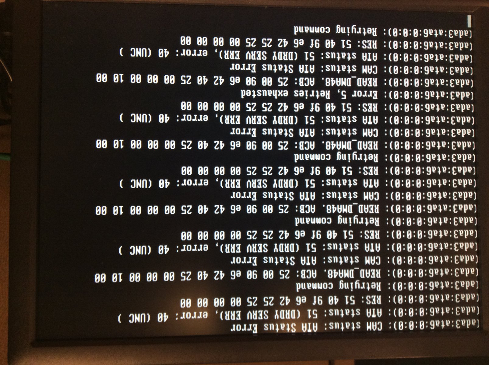

at this point i have pulled the drives out of the machine and have tested them one by one, seems one of the drives has failed although i still get the bus error and not sure what its referring to.

Wait for the prompt that says press enter, and do that. You should then have a shell to type into.

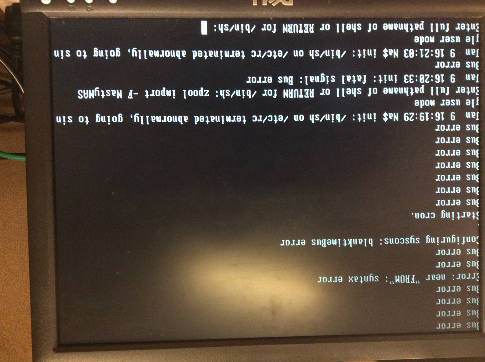

You're saying you got the bus again error AFTER the "Enter full pathname of shell or RETURN for /bin/sh" message? That last screenshot shows it before.
sgtslaughter009
Jan 9, 2015
12
Yes as per the screen shot it shows the bus error>then i get "Enter full pathname of shell or RETURN for /bin/sh" and upon entering the "zpool import -F NastyNAS" what results from that is
Jan 9 16:20:33 init: fatal signal: Bus error
Bus error
Jan 9 16:20:33 init: /bin/sh on /etc/rc terminated abnormally, going to single user mode
Enter full pathname of shell or RETURN for /bin/sh:

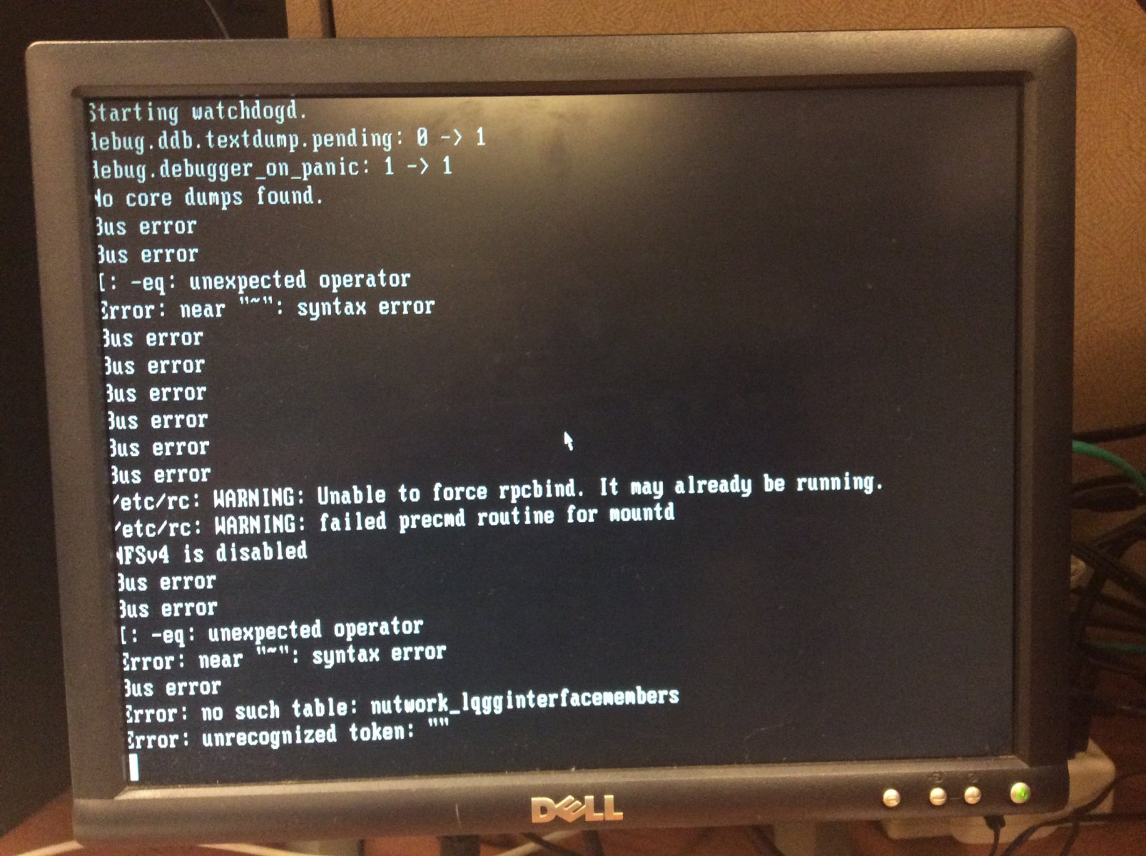

Sounds like either a bad USB stick or a failed disk. Try burning the same version of FreeNAS to a new USB stick and booting from that.

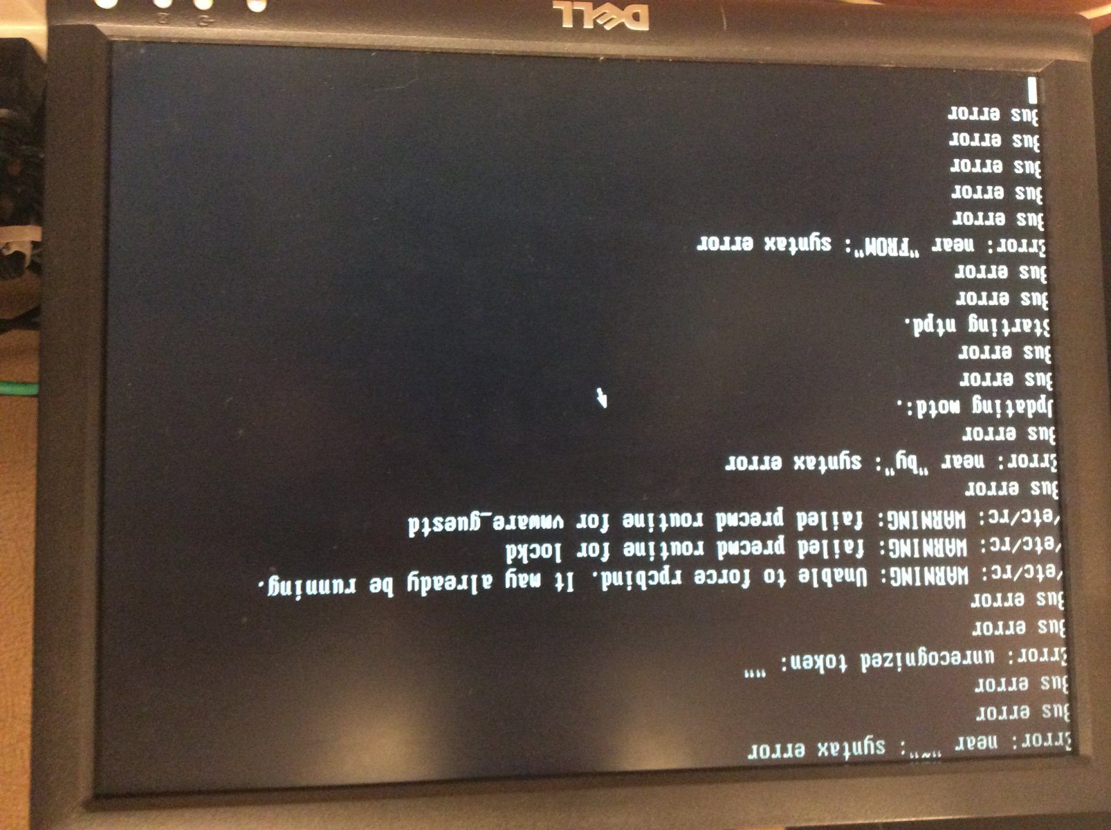

i tried pressing enter after that then entering the command again and get this

so i had my download of 9.2.1.5 and i was able to reinstall freenas. it looks as if it boots normally although when attempting to access the webgui i receive the following error

If you're getting SIGBUS errors on the machine, that either means you're seeing some sort of memory corruption - Intel ARK doesn't indicate the Pentium Dual-Core E5200 as being ECC-capable - or the USB flash drive is going, and corrupting your OS installation. Can you boot the same USB flash disk on a different machine? Can you boot another OS via a different USB flash disk on the same hardware? Have you tried running Memtest86+ on the machine?
If your memory is in fact failing, the pool may already be eaten. If it's just a crap USB flash disk, install FreeNAS on a new one, reimport your saved config (you did save a config backup, right?), and then re-import the pool.
