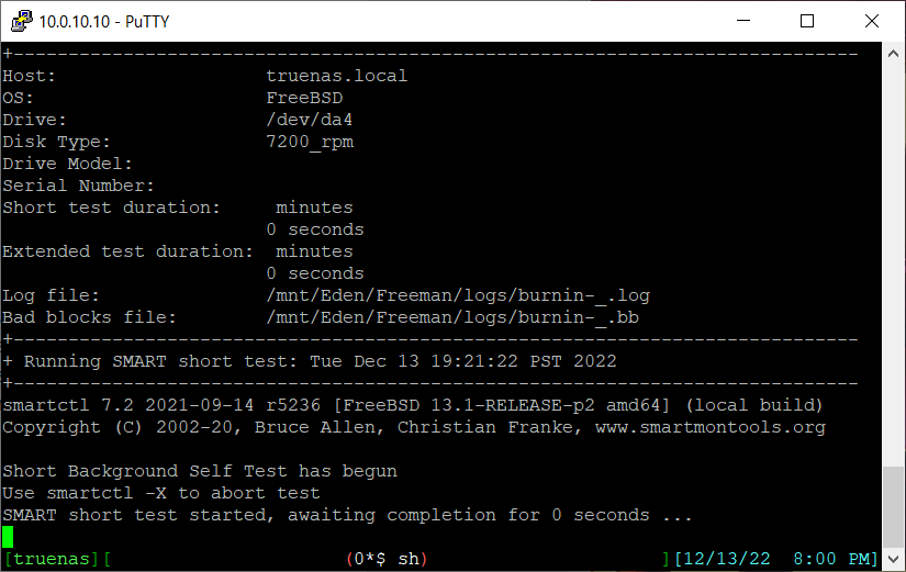

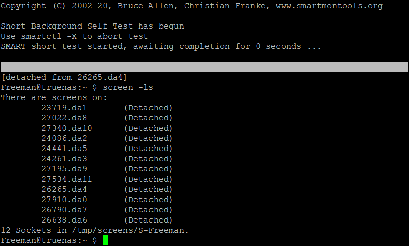

  • Created 12 screens in Putty for all my 12 drives and ran in each the command sudo ./disk-burnin.sh -f -o ~/logs da0
  • Detached all screens one by one with Ctrl-A + D, closed Putty
  • Opened Putty used the command screen -ls to list all screens
  • Verified progress of a hard drive with command screen -RD da7

  2. When I detach my screens, close my computer and reboot it (need to do this for work), is it still running in the background on the server?

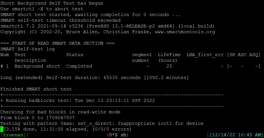

Here are some screenshots of Putty, maybe it can help understand where I'm at.

2. When you detach from screen session the script will continue to work.

Thank you very much for your answers. The Smart test didn't show progress but once it finished the badblocks process do show progress. It's now over 70% so I guess I'll lose my logs as I ran like a noob the test on the pool where the script is. I guess I'll have to re-do a test after this one finishes.

Here's a screenshot of the progress so far for reference.

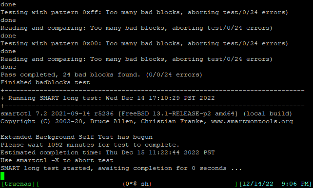

Just saw that all of the 12x drives are showing 24 badblocks, is that because it's on a raid? The chance that all 12x drives all have 24 badblocks is improbable... It's currently doing the SMART long test, let's see the log files tomorrow. Also I don't understand how my user folder with the script on this pool wasn't deleted after running simulteanously the badblocks test on all 12 drives.

Is there a way to customize the badblocks options so I could use -w and write the four patterns (0xaa, 0x55, 0xff, 0x00)?
The script use -w option, these are parameters for badblocks in script:
badblocks -b 8192 -wsv ...
About similar errors on all drives I think best option is to destroy the pool and test drives when they are not participate in pool.

It did work to remove all the drives from the pool. All 12x drives seems to report no apparent errors after 6 days of running the tests.
Here's the log of a drive showing the error
Loss of dword synchronization count: 2
and this error is present at the same value for each drive. There's absolutely no chance that 12x drives would show the exact same amount of the error and the same error. Is there an issue with my drive controller?
