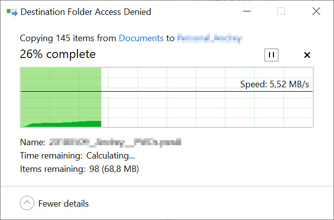

In some cases (not always) copying of existing folders, files (overwriting) is stopped due to the "Destination Folder Access Denied"
In some cases pop-up allows to retry and it is successful (copying continues), in some - retry is not possible.
When pressing "skip" - process continues and files and folders can be copied into even the folder, which has been previously indicated as "Access Denied"

When user copies the same set of files, and there are directories, some directories start issuing the message "Destination Folder Access Denied" no permission to write into this directory. The retry in some cases works, in some - not.
If "skip" is pressed - in some cases files are copied further, also the ones, which are in the folder, where just seconds ago "Destination Folder Access Denied" message was popping up... the new files and/or directories are copied to the NAS (usually) with no issue.

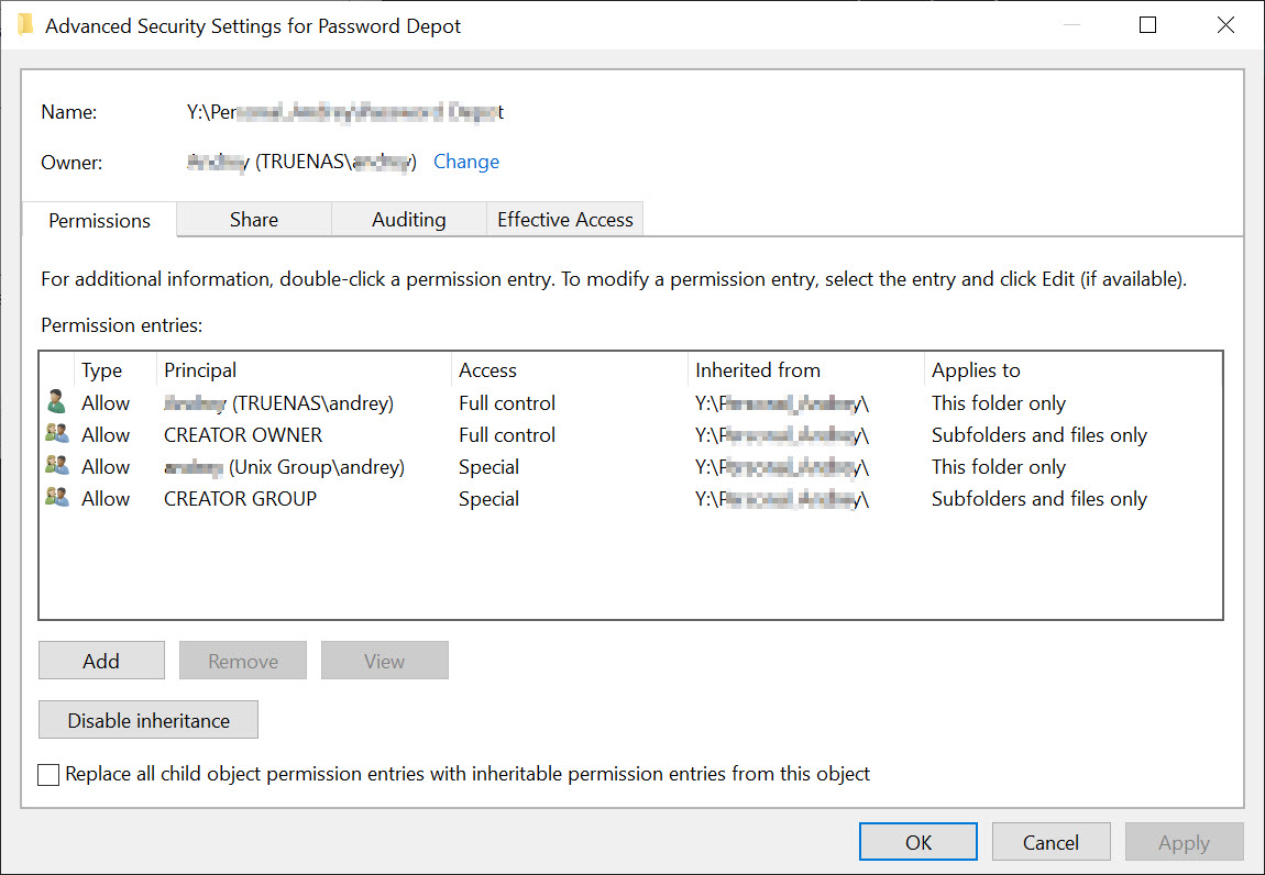

Checking the authorization on the Windows side - settings confirm that user has a full control and ownership of this folders.

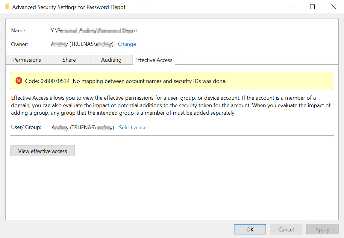

but Effective access fails with message: "Code: 0x80070534 No Mapping between account name and security IDs was done." - and I am not sure whether this is normal.
