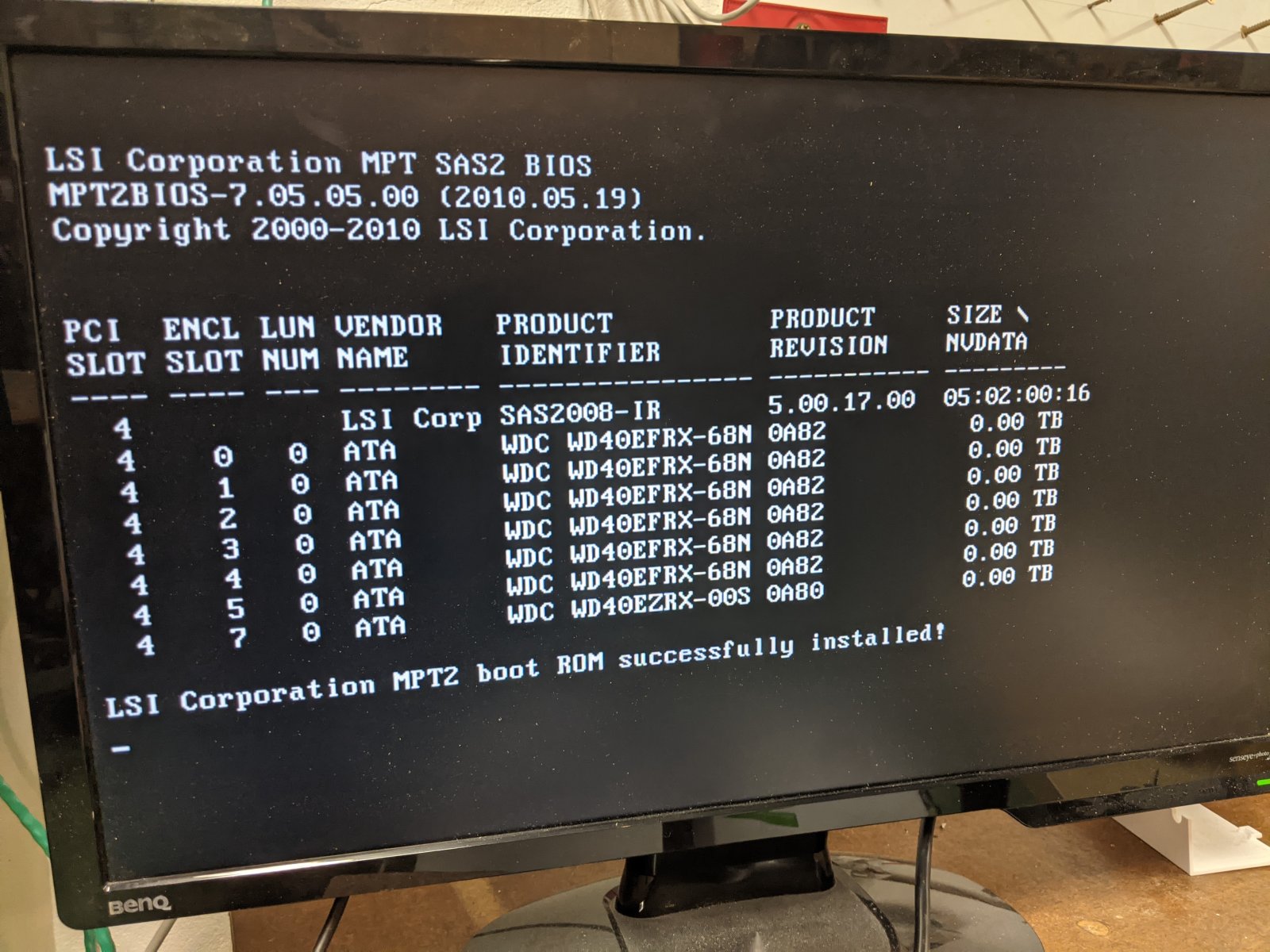

1) The LSI "boot screen" reports all my drives as 0TB in size (attaching a picture of that).
