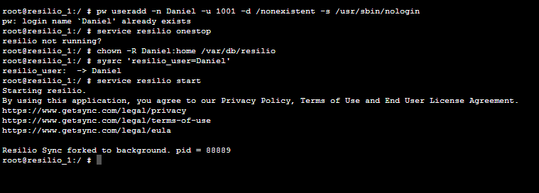

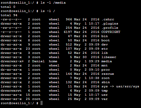

Djc83
May 1, 2017
3
After doing a little more playing around with how I was typing the names in when attempting the commands I did learn that for some reason even thought I have my group name as "Home" when i type it in I have to use "home". After that any making sure my uster account was not btsync but resilio sync. Goes to show how easily I overlooked things when trying to follow setup guides that are still for btsync.
I am still having the write permissions message pop up after I got solution 2 and 3 to work. Below is all of the commands I did. along with the outputs of both commands

Joshua Parker Ruehlig
Dec 5, 2011
5,949
which solution did you do?
did you still have an error you need to solve?
your /media folder has windows ACLs enabled, so even if you follow a solution perfectly it still might not work. i don't know anything about them and have avoided them
