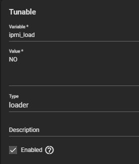

For anyone else stuck on this, when this post doesn't work - https://www.truenas.com/community/threads/boot-hang-ipmi-system-interface.69103/#post-475032 (booting in single user mode still tries to load the ipmi kernel module, and therefore freezes), the solution was: during boot, choose "3 - escape to loader prompt", you should be at an "OK" loader prompt. you need to append the ipmi modules to the existing module_blacklist variable, then boot into single user mode by running:
set module_blacklist='drm drm2 radeonkms i915kms amdgpu ipmi ipmi_linux'
boot -s
then it will succesfully boot all the way into single user mode, choose the default shell when asked then you can actually run the following:
su -
mount -u -w /
cd /boot/kernel
rm ipmi.ko
rm ipmi_linux.ko
exit
Once succesfully booted, in the web UI I also added a tunable with a type of "LOADER", variable of "ipmi_load" and a value of "NO", as the default /boot/loader.conf is populated with ipmi_load="YES". This didn't seem necessary, but did it just in case. Note future truenas updates could repopulate the .ko modules you deleted and you could get stuck on boot again. A real fix upstream would be nice but it seems like a problem only affecting two or three motherboards out there
