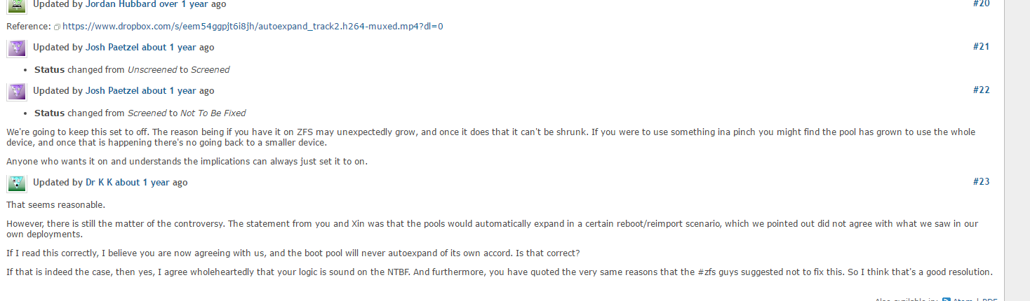

The autoexpand is off because (if memory serves me right) the boot manager (g-something.. I'm tired) doesn't handle autoexpanded zpools very well.
If you want to go to a bigger zpool I think the only option is to simply do a fresh install on the new disks, then import your config file.

Very interesting bug report and oracle docs. Looks like it's possible to move to the bigger devices, then either set autoexpand=on (temporarily to expand then set to off), or zpool online -e.
http://docs.oracle.com/cd/E19253-01/819-5461/githb/index.html
Since Oracle's code is several years apart from the OpenZFS project, I wouldn't trust that it is 100% correct until someone actually verifies the behavior. Any documentation from Oracle should be assumed to be "incorrect" until proven otherwise to be on the conservative side.
