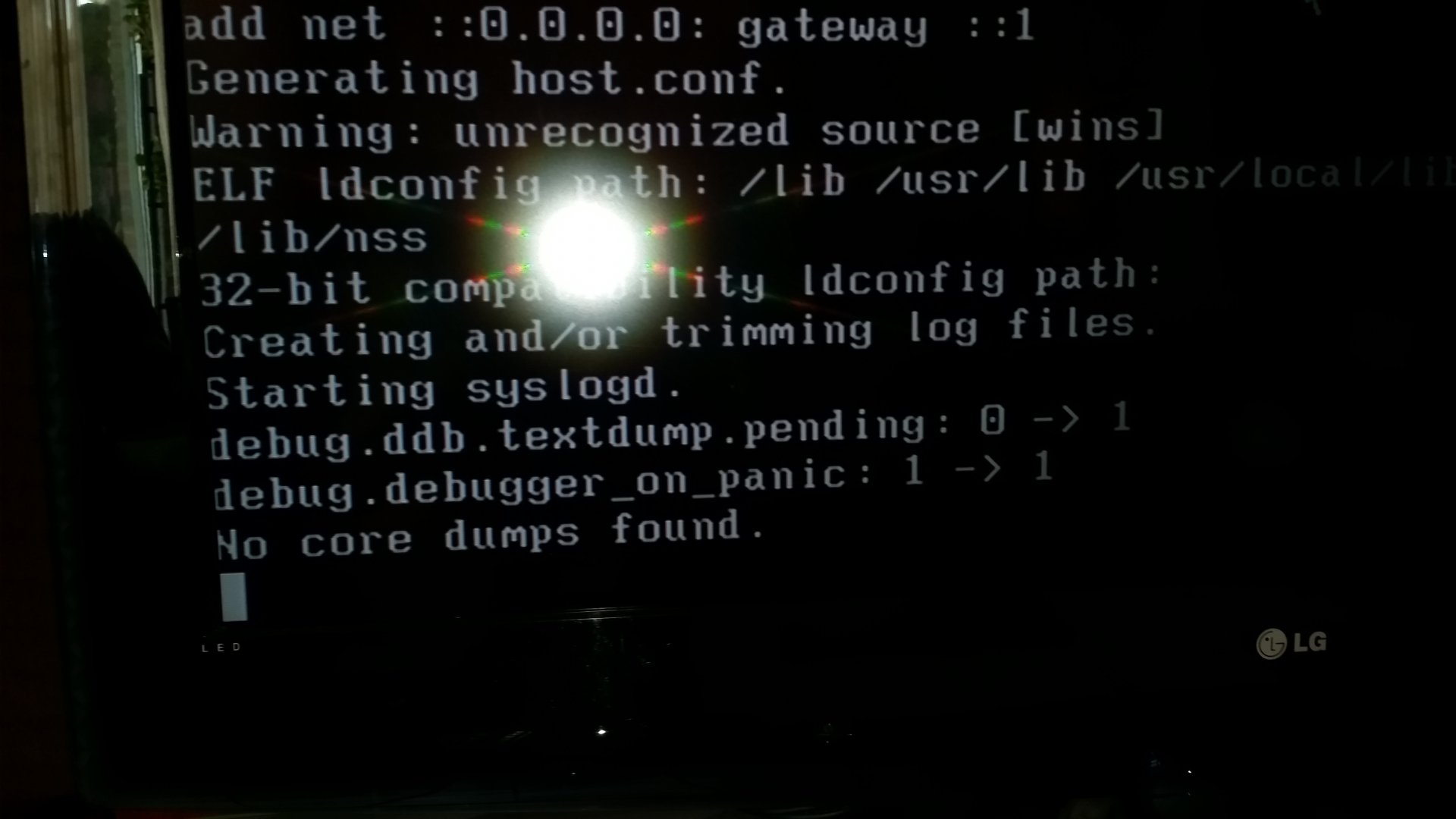

I also have run into the issue where as soon as Feenas (9.2.1.5 or even 9.2.2 - which is still beta at this time) will be added to AD and one of the folder shared (CIFS) after reboot it will be stocked at "no core dumps found" . I have also tried this but no success:
Boot in single user mode
- run this command to make the boot drive writable: mount –uw /
- run this command to edit the file: ee /etc/rc.conf
- change the line: watchdogd_enable=”YES” to watchdogd_enable=”NO”
- run this command to make the boot drive read only again: mount –ur /
- restart the PC with this command: shutdown –r now
IF anyone has any solution to that problem please advise
