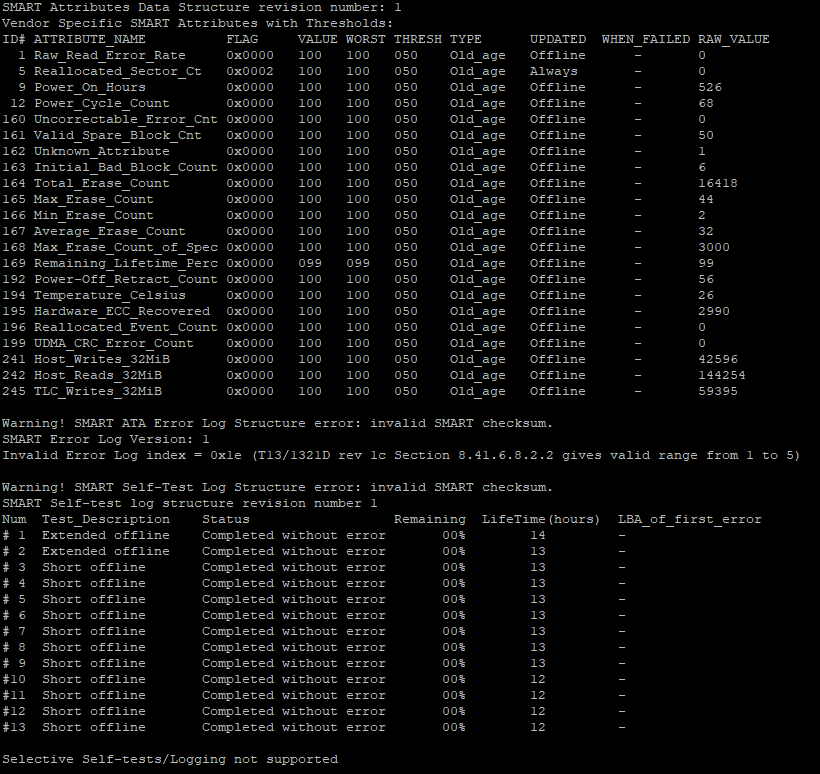

and performed the SMART long test, but there is nothing describes into the guide that could help here. Here is the outcome of the test:
I just noticed some warnings however that I am not sure it links to my issue.

When using this type of setup, you most often will not get accurate SMART data from the drive, and SMART tests may not finish, if they even run.
Your GUI issue and lock-up is very likely caused by how you have the boot pool connected. If you want to use USB (not recommended), use a true USB flash drive, not some SATA to USB interface.
and performed the SMART long test...
Those warnings are most likely due to your using a USB interface on this drive. Fix that and see if your problem goes away.

Finally, I prefer to keep my setup the way it is, just disabling the SMART monitoring of the SSD.
On worst case, the system will go mad, and I would finally have to do a reinstall with config import.
I am backing my config every month on external drives, I should be safe on this side.
And since I have disabled the SMART feature on this SSD (just a few days now) I do not have any errors, so perhaps it should be enough for me :)
