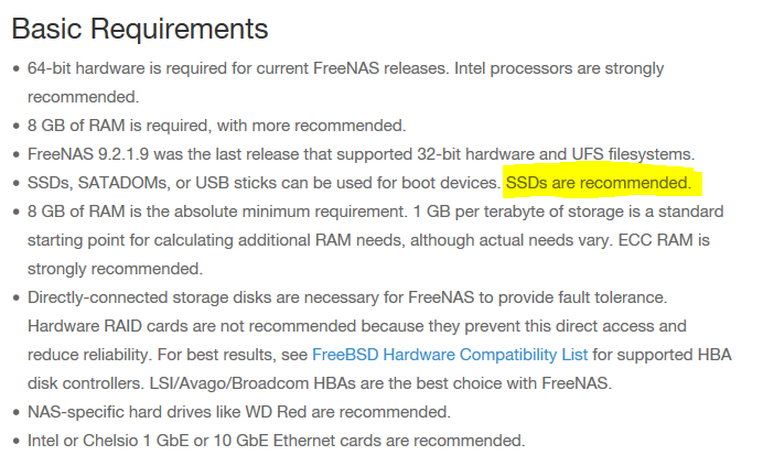

No USB Memory sticks? I've heard the contrary to point that it's actually recommended.
If you search the forum, you will find lots of discussion about booting from USB thumb drives. They work, but even the best ones are not reliable and they do go bad - often when doing system upgrades. Newer versions of FreeNAS are a lot more susceptible to this than older versions were. You can still use thumb drives, but many folks are now using small SSDs. They are cheap enough, and makes for a much happier experience.
Chris Moore
May 2, 2015
10,079
You heard that where? How old was the data? Things change over time.
I am going to post this screen shot so I can highlight the relevant portion of the information:
If you wan to read it yourself, here is the link:
https://www.freenas.org/hardware-requirements/
Please pass the word; tell all your friends, family, acquaintances, people you don't know…
Binary Buddha
Mar 6, 2016
126
They need to reword the installer. It says a "flash drive" is recommended. When you say a "flash drive" most people think of "thumbdrives" not SSDs. And the issue didn't have to do with the thumbdrive I was using. It was the IPMI BIOS setting somewhere that had to do with "Power Efficiency".
