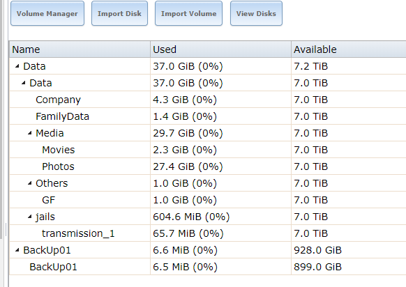

I have a backup volume (BackUp01 :- single 1TB disk) that I wanted just to keep files as a backup. What is the best way to secure this drive? I was thinking if there is a way to make it detached/offline when not in used. Is this at all possible ? Thanks in advance.

My old N40L running on Windows was ransomwared couple of weeks ago. I do not want it to happen again. So, i'm now running this FreeNAS on the N40L (first time using a linux box), and it is connected to my router. So, i want to backup my data into this BackUp01 and make the volume 'offline' while not in used - something like plug/unplugged a USB drive in Windows ? I know FreeNAS is much secured than a W machine, but i am just worry that same thing might happen to it in future.
