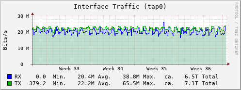

Interior cameras are 4MP which can be found for about $130 on Amazon. The exterior cameras are also 4MP but a bit more expensive because they have the rugged housing.
Click the 'Show: Home NAS' link below to see the specs.
Here is the FreeNAS CPU usage, always under 20%...
Here is the network traffic from the VM's cameras and writes to the NAS....
I've given the VM four CPUs and 4GB of RAM. I'm pretty sure I could give it one or two CPUs and 3GB RAM and it would be just fine...
GeoVision (free for up to 32 of their PoE cameras) is lightweight. Even our office system with 30 cameras isn't on especially beefy hardware. It lives in a XenServer VM assigned just 8G of RAM and eight Xeon x5560 cores.
Depending on what cameras and network video recorder you're using, I think you'll be fine with your hardware and might just add RAM.
