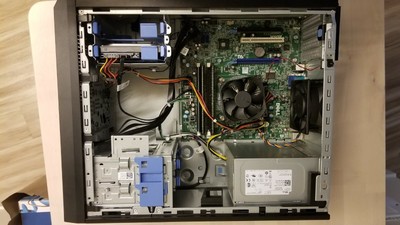

I use Dell T110 II. They are designed for use in an office environment so are reasonable quiet.
By using a 5.25 to 3.5 cage I am running 6 drives in each.
Source it with a E3-1220 and H200 HBA :

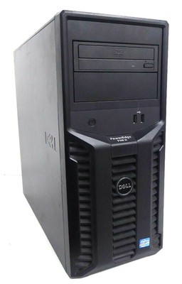

Thanks for this. Looking for my first build and this lead to finding this for $250 delivered:
Dell PowerEdge T110 II 4-Bay LFF Tower E3-1220 v2 3.1GHz 32GB PERC H200A
Good price?
