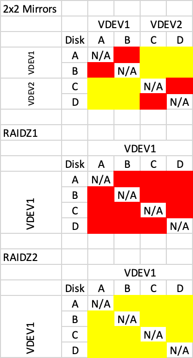

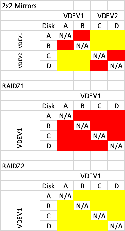

Just from a pool resilience viewpoint, here's what can happen as you lose a disk and then a second one (disk labeled A-E).
Yellow is a degraded VDEV/Pool and Red is an entirely dead pool.
Clearly if pool resilience is your priority, RAIDZ2 is the option.
With a hot-spare, you may still lose a second disk during resilver (which stresses the remaining disks heavily), so it's potentially no better than without the hot-spare in that case.
