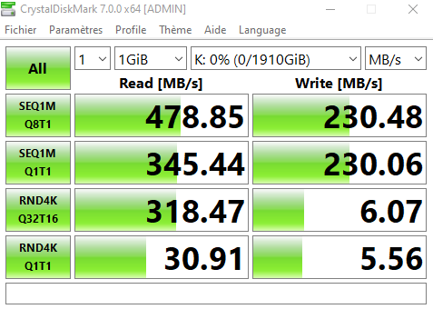

So basically when plugging any of the SSDs on the H730 CARD running the last DELL firmware (25.5.6) I get the following performance :

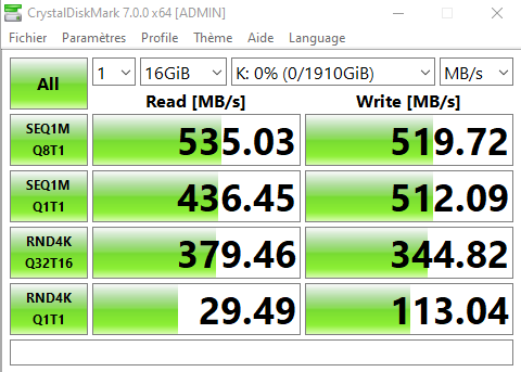

On this test, using a MX300 SSD I don't even bother using a big test file, so the writing should all go to the SLC cache of the SSD which allows something like 500 MB/sec writing speed.
I've tried of course with the SSD directly linked to the motherboard, here is the result :

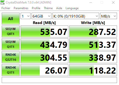

Even when using a 64 GB test file it is still much better than through the H730 raid card :
