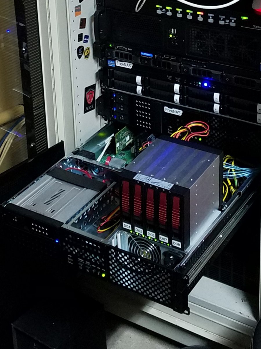

Your welcome. That enclosure and the 8 bay versions look good. Not much to go wrong with them. If you open them up they are just a PSU and a reverse brake out cable. It's the same thing I use for testing HBAs and doing drive burn-in. Like in the picture below. I'm testing a 9207-8e and 4 WD Re drives I picked up used. There isn't really much to go wrong with those disk shelfs if you get one used. The Expanders, PSUs and backplanes are relatively cheap. I plan to pick one up in the next free months.
