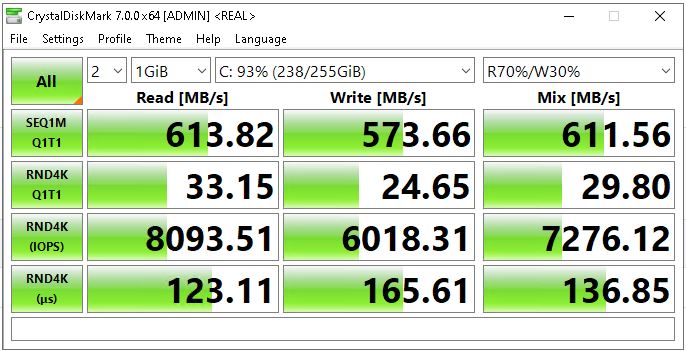

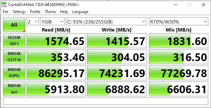

I'm please with the performance from within an ESXi VM using this old hw as it's datastore, limit now seems to be the 2x 8Gbps FC ports.
