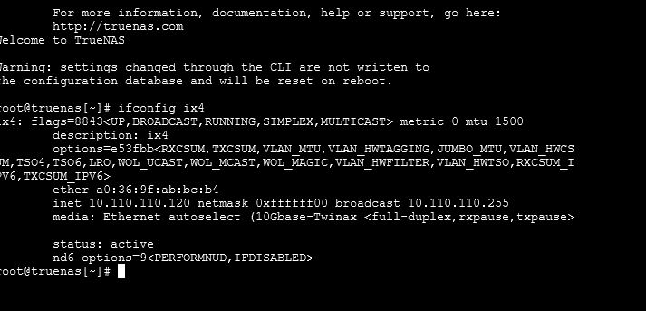

My network cards have WOL, but I do not find this function in the BIOS
