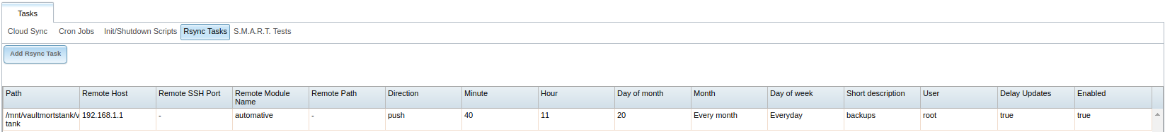

You just want to use the BIOS to turn the system on, not off. The command for system shutdown in unix (which FreeBSD is and FreeNAS is built from FreeBSD) is this: shutdown -P now It will bring down the system immediately, and automatically power off the system. When that command is issued, anything that is running will be stopped. It is issued from the command line, but you can put it in a cron schedule so that you can have it happen at a specified time. To figure out when you need to do that, you will have to run the rsync task a few times to see how long it usually takes to complete the transfer. You can monitor the CPU activity on the two systems to see when the rsync is running. It will start low, when the files are being compared, then jump up when it is actually transferring files and drop back down when it is done. When my system is running the transfer it will average around 20% CPU usage on the sending system and around 10% on the receiving system. Once the CPU utilization drops to a low level, you probably want to give it a few extra minutes to ensure everything is finished and then the system can be shutdown. Anything that is not done can be copied on the next sync. After the first sync, which can take days over the network, the updates can be done in as little as half an hour, depending on how much you have changed. You will want to figure an average for how long they take and give it a little extra time, then schedule the shutdown accordingly. This may take a week or more to get figured.
Have i done this correctly? I cant seem to get it working.
Server 1

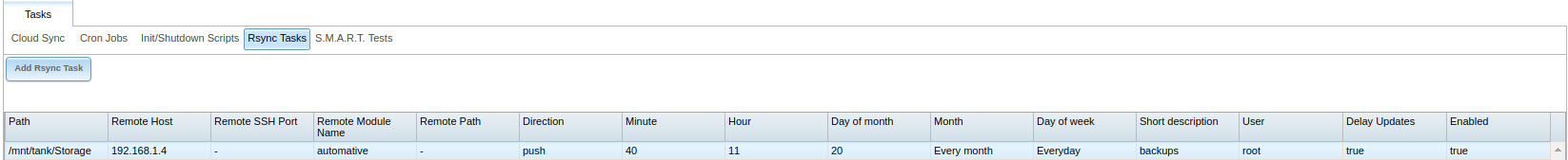

What about Server 2?

Rsync doesnt work. Ive spent so many hours now trying different thing but doesnt work. Everytime i try something different i keep getting this error any ideas?
Feb 28 10:49:00 vaultmort rsync: @Error: Unknown module 'sync'
Feb 28 10:49:00 vaultmort rsync: rsync error: error starting client-server protocol (code 5) at main.c(1662) [sender=3.1.2]
Chris Moore
May 2, 2015
10,079
Rsync doesnt work. I've spent so many hours now trying different thing but doesnt work. Everytime i try something different i keep getting this error any ideas?
I gave you a web link to the "how to" for the setup. You might have missed a step. The rsync module is configured on the target system so it knows where to put the data that is sent from the source system.
