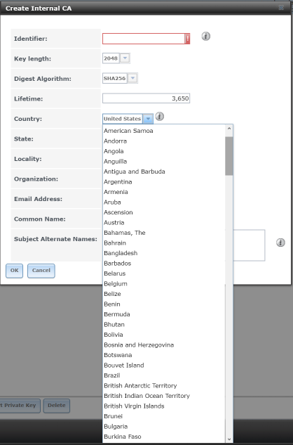

I am creating a new internal CA certificate. In the drop down box for selecting the country "Australia" is missing.
See attached picture.
It is interesting to note that I had previously created an internal CA without any problems. Australia was listed.
A recent upgrade to the 11.2-BETA1 (by accident mind you) seems to have caused a few small issues here and there.
None of which are show stoppers.
(I've tried updating to the 11.2-BETA3-4 and even though it is showing as being activated on reboot it never does, still trying to get to the bottom of that one)
Is anyone else missing Australia as a country from the dropdown box?
Is there a way to create the CA via the CLI?
Thanks for any help

I'm pretty sure we recently fixed this in one of the BETAs... Does updating to RC1 resolve the issue?
