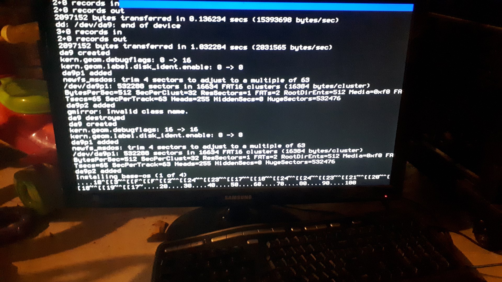

I recently received notification via e-mail and the UI that my 11.1-U7 boot pool was degraded. I have finally started the process of removing the old thumb drives and putting in new ones.
After shutting the system down, installed the boot image to a USB drive, booting, and selecting to install the OS to another thumbdrive, the process appears to have started the installation. However, the installation appears to have stopped at "da9p2 added". Image attached. It's been this way for 15-20 minutes at the moment, a lot longer than I'm expecting and, hence, a little anxious.
Do I keep waiting [USB drive being slow?] or do I need to backout, somehow, and start again? Or are my expectations on speed out of wack?
I have a backup of my 11.1-U7 configuration for when I get back in.
Thanks all.

As if to make a liar of me, the system has just appended
Installing base-os (1 of 4)
to the screen. Maybe I just need to wait...

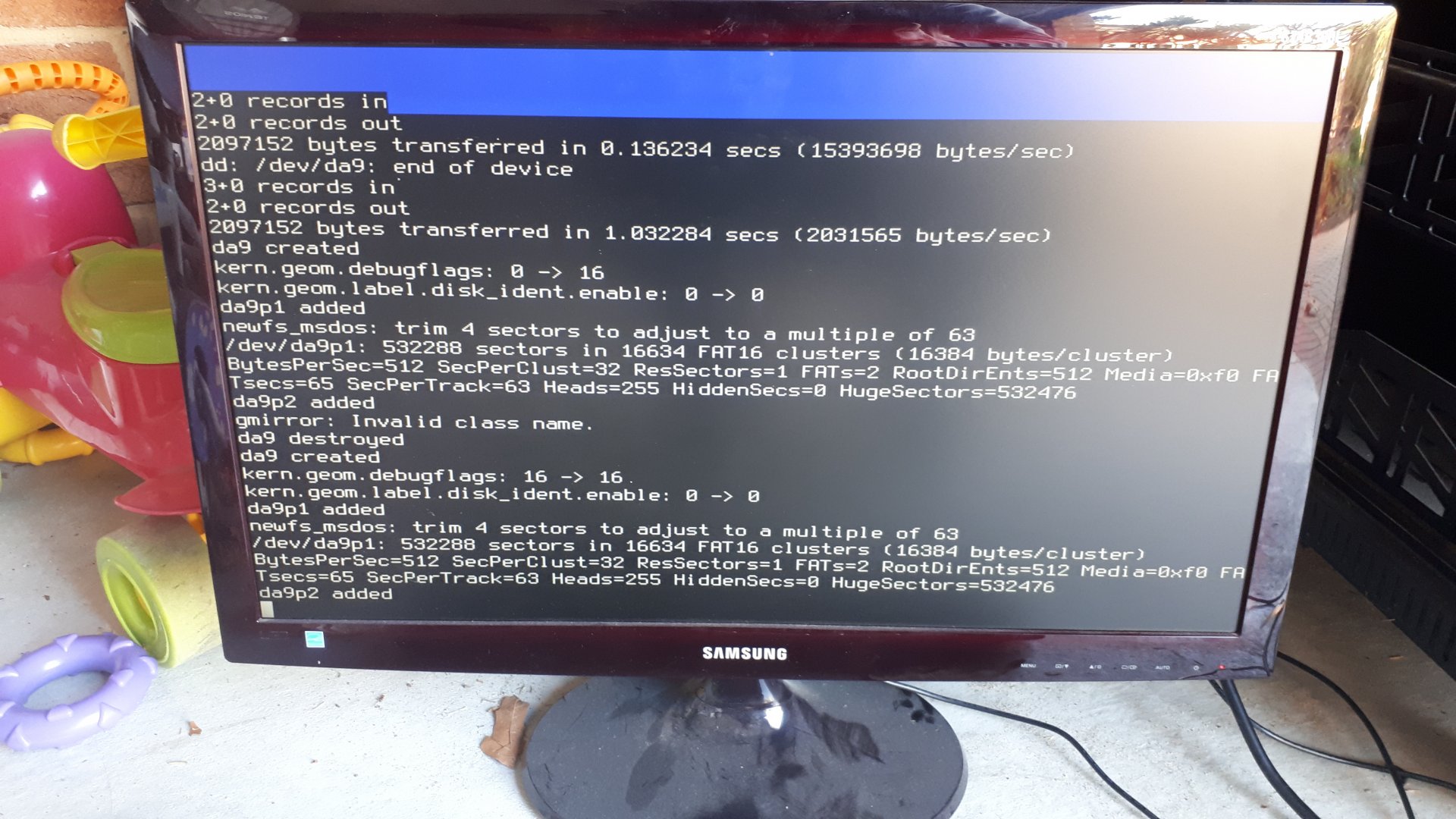

Hi All,
A few hours later and although there has been some progress; system install now appears to have stopped at, what I'm interpreting as, the 100% mark of base-os (1 of 4). I'm not sure what to expect as I don't recall my original installation of FreeNAS taking anywhere near this long.
Any feedback, advice, reassurance appreciated.
System being installed on Toshiba 16Gb USB drives.

I have had better "luck" installing from an install disc instead of USB thumb drive .. even when it did finish installing, I'd get weird other type of errors with my server while it was up and running ..it still seemed to do what I wanted ok despite the errors..
Installed from an ISO image burned to a disc and installation went fine and no more odd errors.
I also ended up installing on to an SSD drive connected via a USB to SATA cable ... that was more than several months ago and still running great
