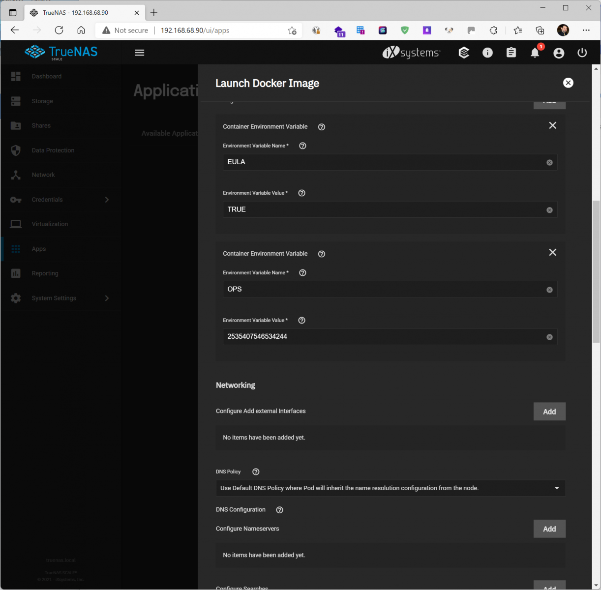

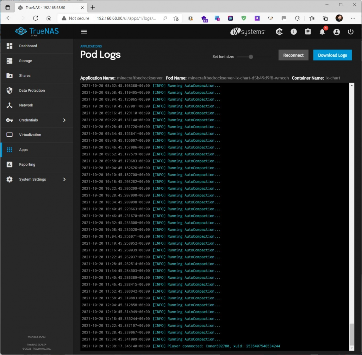

You had me thinking and I solved this by logging into the server and the looking into the logs:
This gave me my own XUID and then as per the documentation here: itzg/minecraft-bedrock-server I added the Environmental variable OPS with my XUID and saved this. (This reloaded the container).
When I re-logged into the minecraft server I was an OP, problem solved :)
I was not able to attach myself to the container, but I actually solved my problem.
