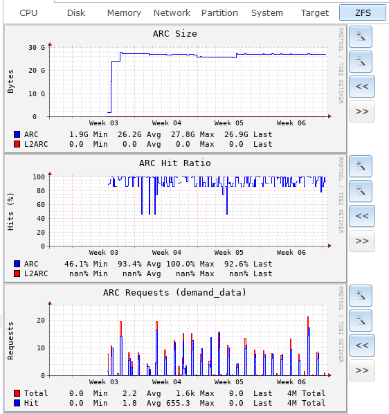

DrKK
FreeNAS Generalissimo
Oct 15, 2013
3,630
