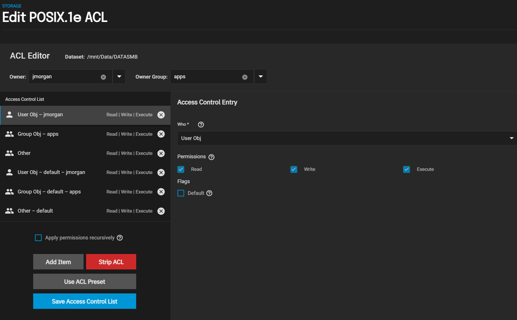

when adding "MediaUsers to the ACL i get this error: [EINVAL] filesystem_acl.dacl: Named (user or group) POSIX ACL entries require a mask entry to be present in the ACL. [EINVAL] filesystem_acl.dacl: Presence of default [OTHER] entry is required.

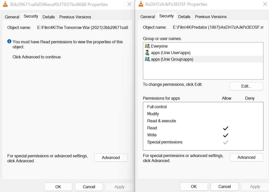

1000 didnt work, had to put it back to 568, its weird, some downloads work some dont, here is the view from my windows machine on the file permissions, one on the left downloaded 1st...
note sure why this happends its rather anoying.
