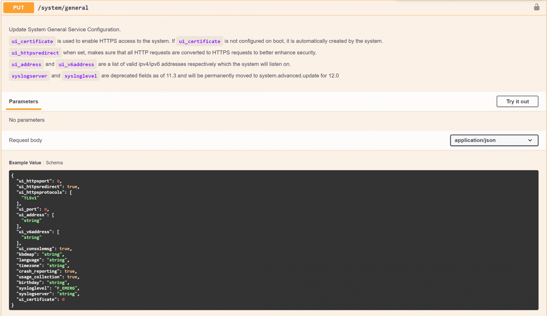

Does anyone know the API call used to change the date and time formats in TrueNAS Scale? You would assume it's the system.general API which seems to include everything related to the System Settings -> General page, however, it doesn't include the date or time formats settings.

There is a "timezone" parameter under system/general.
There is also a timezone_choices API that will give you the list of valid options.

Hi, that's the API call that I would have assumed would allow you to change the date and time format, however, if you look at the key/value pairs available, none of them actually set the date or time format. It's either missing from the documentation or another API call is used to change the date and time formats.
Thanks,
Harry
EDIT: Just to clarify, by date and time formats, I mean changing MM/DD/YYYY to DD/MM/YYYY for example, or changing from 24 hour time to AM/PM time.
