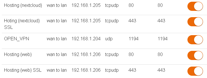

I have port 80 and 443 open for the two Jails.

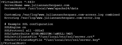

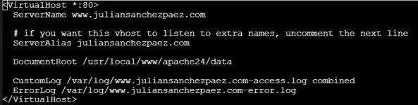

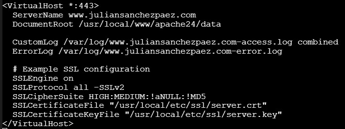

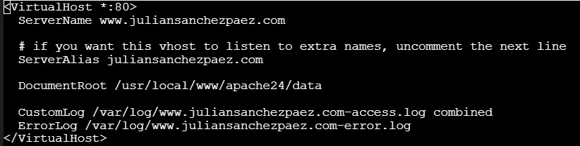

Yeah! I have created .crt .csr .key files.
Also in the /usr/local/etc/apache24/httpd.conf file, I have it listening to ports 80 and 443, I have uncommented the SSL module, I have configured the ServerName with my domain and an include of the file where I have defined the VirtualHosts.
It won't let me see the web page with http or https.

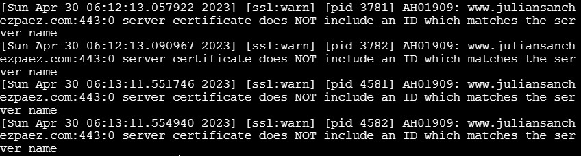

And what does your error logs say?
Juliii98
Apr 24, 2023
3
Sorry for taking so long, I've had connection problems. The error in the log is as follows:
www.juliansanchezpaez.com:443:0 server certificate does NOT include an ID which matches the server name
