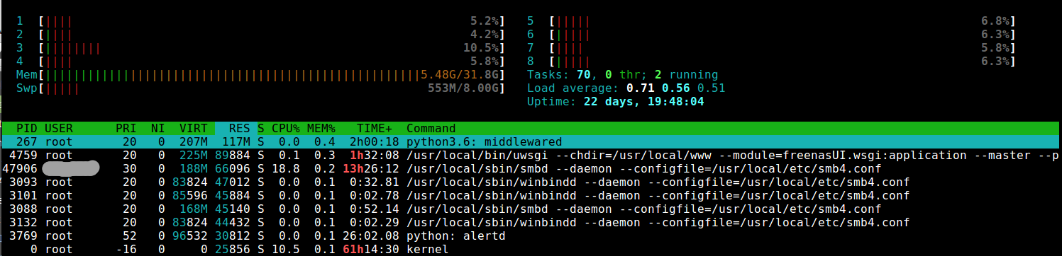

SOLVED Any idea why my idle FreeNAS is swapping?
NASbox
May 8, 2012
650
My FreeNAS box is sitting mostly idle (have an ssh session with tmux running), and a couple of Samba shares that aren't doing much, but for some reason there is over 500MB on the swap. I have 32GB of RAM and 2 Pools 8x6TB RaidZ2 and a 2x4TB mirror.
Is there something I need to change/tune?
I don't know how long this data has been on the swap, but I should mention that when I booted FreeNAS, the first thing I did was replace and resilver a 6TB that had been removed/RMA's after a disk failure on my main RaidZ2 pool. Does resilvering cause swapping to occur?
I also ran this script: (to see if it would provide any clue)
https://github.com/ocochard/myscripts/blob/master/FreeBSD/freebsd-memory.sh
SYSTEM MEMORY INFORMATION:
mem_wire:       32223371264 (  30730MB) [ 96%] Wired: disabled for paging out
mem_active:  +     24322048 (     23MB) [  0%] Active: recently referenced
mem_inactive:+    254951424 (    243MB) [  0%] Inactive: recently not referenced
mem_cache:   +            0 (      0MB) [  0%] Cached: almost avail. for allocation
mem_free:    +    489963520 (    467MB) [  1%] Free: fully available for allocation
mem_gap_vm:  +    276844544 (    264MB) [  0%] Memory gap: UNKNOWN
______________ ____________ ___________ ______
mem_all:     =  33269452800 (  31728MB) [100%] Total real memory managed
mem_gap_sys: +    867729408 (    827MB)        Memory gap: Kernel?!
mem_phys:    =  34137182208 (  32555MB)        Total real memory available
mem_gap_hw:  +    222556160 (    212MB)        Memory gap: Segment Mappings?!
mem_hw:      =  34359738368 (  32768MB)        Total real memory installed
SYSTEM MEMORY SUMMARY:
mem_used:       33614823424 (  32057MB) [ 97%] Logically used memory
mem_avail:   +    744914944 (    710MB) [  2%] Logically available memory
______________ ____________ __________ _______
mem_total:   =  34359738368 (  32768MB) [100%] Logically total memory

Were you able to determine the cause?
Because he has relatively little memory, and at some point there was momentary memory pressure and a massive amount of swap-eligible user pages.
Even an incredibly heavily resourced FreeNAS system can see this at times.
All that's really going on is that there's a brief userland spike in memory demand. Maybe someone logged into the GUI and a bunch of stuff started executing, or even just a cron job ran. If this happens at the same time as ZFS has allocated all the "free" memory and is actively using it as ARC, you can get a momentary run on memory. ZFS is supposed to free ARC in order to "make way" for userland, but this doesn't actually happen instantaneously, and the kernel may instead consider it a memory shortfall and start the process of swapping stuff out. Then ZFS releases some ARC and the memory pressure is gone, but in the meantime some stuff has been swapped out. The exact interaction has changed a bit over the years as ZFS has been made to behave better.
Thanks @dlavigne for giving this thread a poke.
Thanks @jgreco for the explanation... I'm pretty sure that this is the explanation. I'll bet that resilvering sucked up all available memory. I did a reboot and haven't seen this again recently.

Yup, resilvering can place pressure on the ARC to "hold more stuff." And under normal operations, a lot of that FreeNAS middleware and GUIware that's in user memory isn't active, therefore looking like a juicy target for swapout by the kernel. The ARC size management code is supposed to make sure that this doesn't actually happen to idle pages, by leaving some free space for userland.
Please don't take it as a criticism, I am just curious, why are you worried about a little swap usage?
Probably because there are so many threads here saying, with some variation, "If your FreeNAS box is using swap, you're doing it wrong." It's never really been true, but any use of swap has long been stated to indicate that your system needs more RAM.
I think you are right about this as I had never seen that behaviour before, and AFAIK, rebooting has cleared it up (I haven't really been looking but didn't anything either.)

"Worried" is a bit too stong... I was curious as to why an "idle" system would be using so much swap, and as @danb35 indicates, I though it might mean that I need to do some optimization, or indicate a software problem that needed to be addressed.
500MB is *nothing* on a system that routinely runs large multi-hundred-MB executables.
