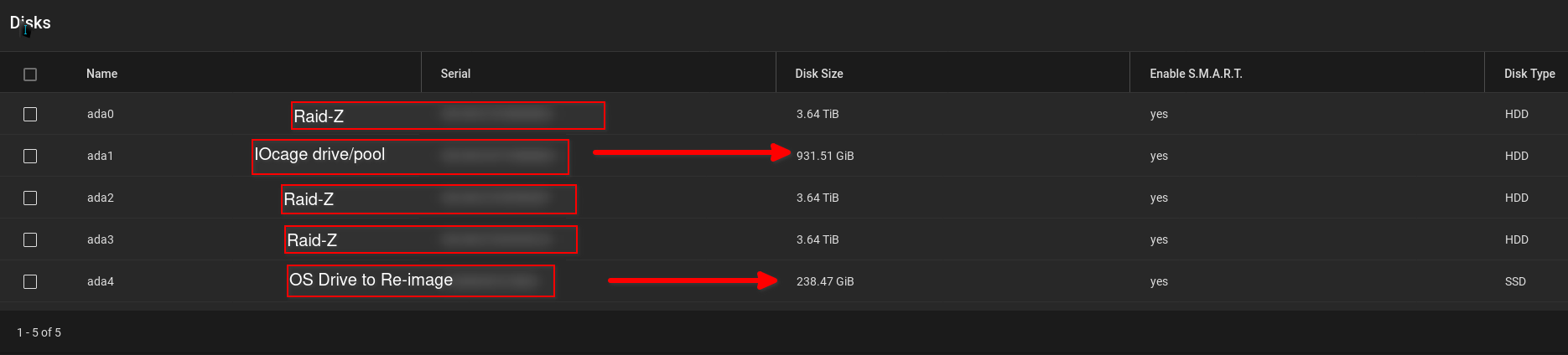

Ive had a few issues as well with the upgrade and things that worked in v11 all of a sudden do not work in v12. I'm debating if its worth re-imaging the OS drive from scratch in hopes that my RaidZ storage pool and iocage pool on the other HDD function like they should again upon rejoining them to a fresh image????
