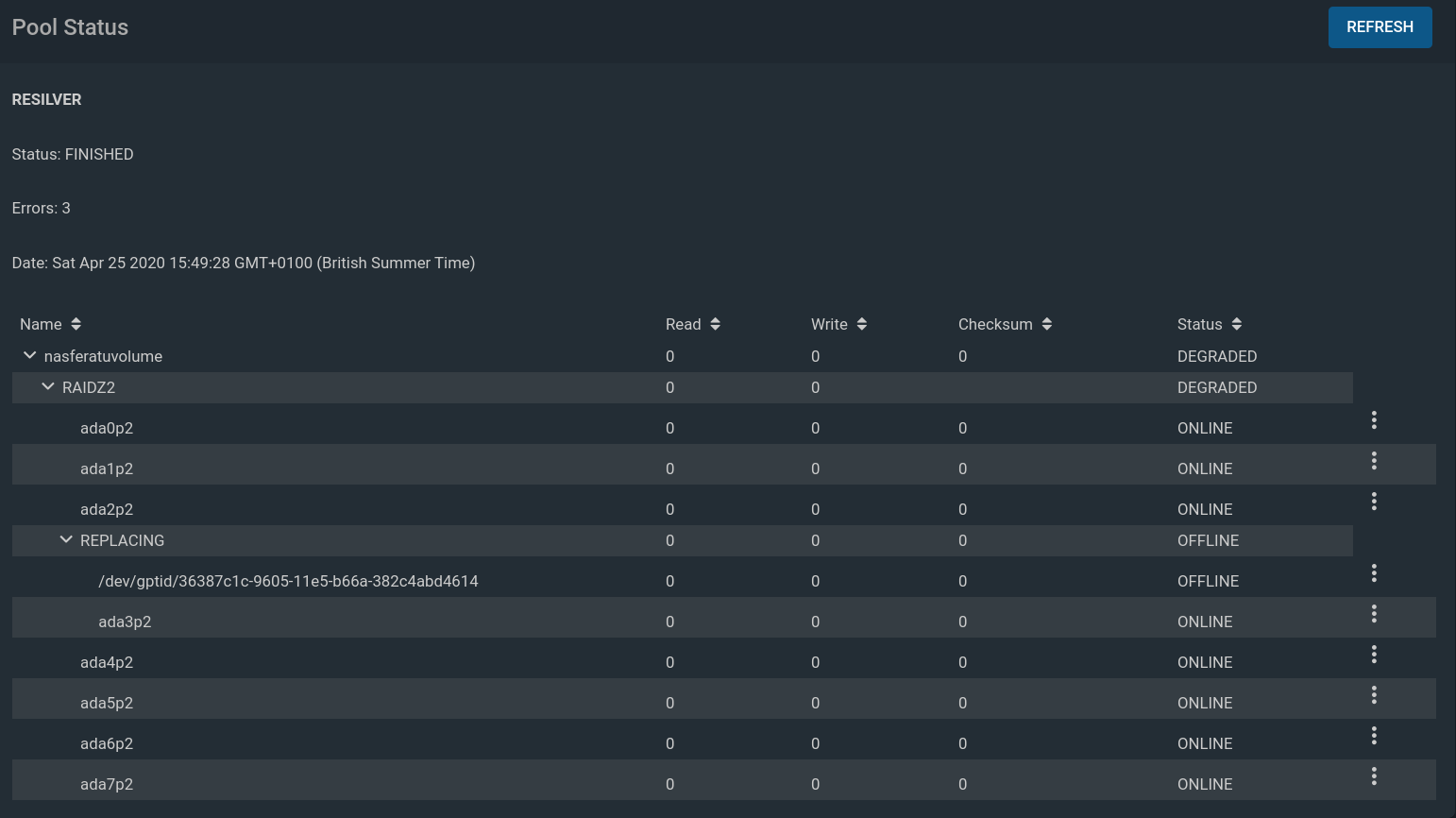

* then I replaced the OFFLINE drive with the new one and then resilvering started
* resilvering took roughly 10 hours and finished @ Sun Apr 26 05:58:46 2020
* during the resilvering process a short SMART test ran and it found two new issues with the other faulty drive /dev/ada5 (which I want to replace next)
CRITICAL
Device: /dev/ada5, ATA error count increased from 65 to 70.
Sun, 26 Apr 2020 12:20:08 AM (Europe/London)
CRITICAL
Device: /dev/ada5, Self-Test Log error count increased from 8 to 9.
Sun, 26 Apr 2020 12:50:07 AM (Europe/London)
Once the resilvering finished (with 3 errors) the status of new drive changed to ONLINE but I the drive is now in strange "REPLACING/OFFLINE" mode.
I tried to detach that OFFLINE " /dev/gptid/36387c1c-9605-11e5-b66a-382c4abd4614" but I got this error:
[EZFS_NOTSUP] Can detach disks from mirrors and spares only
PS. The full stacktrace for that error at the end of this post.
I then checked pool status via CLI and it showed me the same 3 permanent errors as before I replaced the drive.
PS. I don't care much about loosing those files.

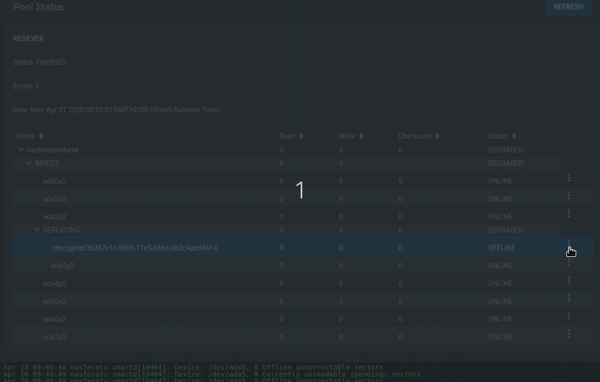

Today, I've decided to clear the errors and try to replace that OFFLINE disk 854069389795236902 with the same /dev/ada3 disk.
So: zpool clear nasferatuvolume did nothing. All three errors were still visible.
Then I replaced that OFFLINE disk, which triggered resilvering again.
10 hours later, nothing has changed.

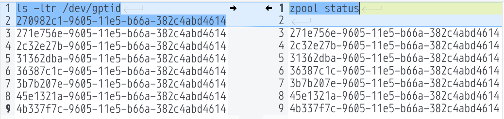

I tried again to detach that OFFLINE " /dev/gptid/36387c1c-9605-11e5-b66a-382c4abd4614" drive and again I got the same error:
Here's a short screencast
psssttt
Aug 24, 2019
29
I wonder why does it say "Detach disk /dev/g?" in that detach modal.
There's no such device on my machine.

Today I tried "zpool replace {pool} {old_drive} {new_drive}" but it didn't work:
# zpool replace nasferatuvolume /dev/gptid/36387c1c-9605-11e5-b66a-382c4abd4614 gptid/f60625cd-8703-11ea-9f29-001b21275bb9
invalid vdev specification
use '-f' to override the following errors:
/dev/gptid/f60625cd-8703-11ea-9f29-001b21275bb9 is part of active pool 'nasferatuvolume'
# zpool replace nasferatuvolume /dev/gptid/36387c1c-9605-11e5-b66a-382c4abd4614 ada3p2
/dev/ada3p2 is part of active pool 'nasferatuvolume'
Any ideas how to fix the issue I'm facing? :(

After replacing the new drive with the old one (I followed the same steps as in the first message https://www.ixsystems.com/documentation/freenas/11.3-U1/storage.html#replacing-a-failed-disk ) and after resilvering I guess I'm back to square one yet again. :(
Old drive is ONLINE whereas the partition for the new drive is OFFLINE.

An attempt to detach the new (yet physically disconnected) drive yields the same "Can detach disks from mirrors and spares only" error as previously:
Error: concurrent.futures.process._RemoteTraceback:
  File "/usr/local/lib/python3.7/site-packages/middlewared/plugins/zfs.py", line 247, in __zfs_vdev_operation
    op(target, *args)
  File "libzfs.pyx", line 369, in libzfs.ZFS.__exit__
    op(target, *args)
  File "/usr/local/lib/python3.7/site-packages/middlewared/plugins/zfs.py", line 256, in <lambda>
    self.__zfs_vdev_operation(name, label, lambda target: target.detach())
  File "libzfs.pyx", line 1764, in libzfs.ZFSVdev.detach
libzfs.ZFSException: Can detach disks from mirrors and spares only

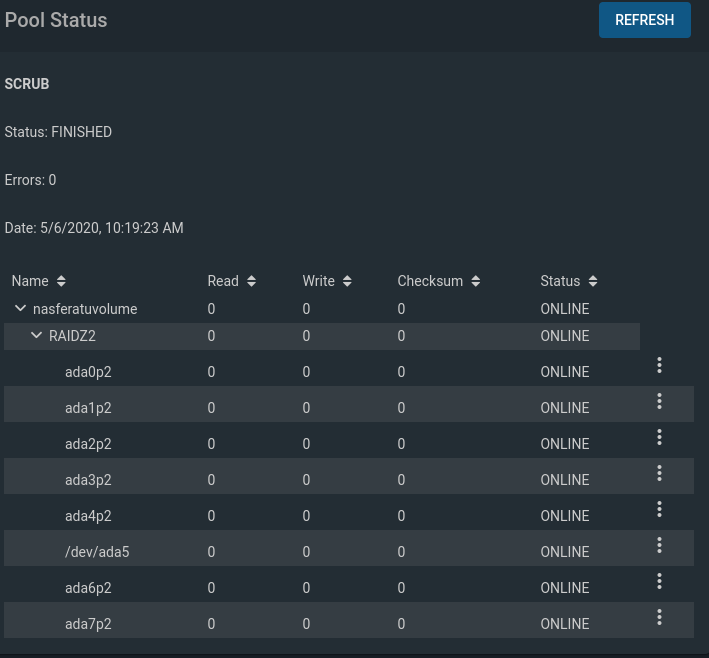

I then detached the old drive from the pool and resilvering kicked in once again:
zpool detach nasferatuvolume 5961868542700033192
zpool status -xv
  pool: nasferatuvolume
state: ONLINE
    corruption.  Applications may be affected.
action: Restore the file in question if possible.  Otherwise restore the
    entire pool from backup.
   see: http://illumos.org/msg/ZFS-8000-8A
  scan: resilvered 3.09T in 0 days 14:20:08 with 3 errors on Mon May  4 01:54:49 2020
config:
    nasferatuvolume                                 ONLINE       0     0     3
      raidz2-0                                      ONLINE       0     0     6
        gptid/271e756e-9605-11e5-b66a-382c4abd4614  ONLINE       0     0     0
        gptid/2c32e27b-9605-11e5-b66a-382c4abd4614  ONLINE       0     0     0
        gptid/31362dba-9605-11e5-b66a-382c4abd4614  ONLINE       0     0     0
        gptid/36387c1c-9605-11e5-b66a-382c4abd4614  ONLINE       0     0     0
        gptid/3b7b207e-9605-11e5-b66a-382c4abd4614  ONLINE       0     0     0
        ada5                                        ONLINE       0     0     0
        gptid/45e1321a-9605-11e5-b66a-382c4abd4614  ONLINE       0     0     0
        gptid/4b337f7c-9605-11e5-b66a-382c4abd4614  ONLINE       0     0     0
I don't understand why does the new drive is listed in the pool with dev name: ada5 rather than a GEOM???? :confused:
gpart says there's not such GEOM:
gpart show ada5
gpart: No such geom: ada5.

I've compared the gptids
ls -ltr /dev/gptid
total 0
crw-r-----  1 root  operator  0x9d May  3 11:28 4b337f7c-9605-11e5-b66a-382c4abd4614
crw-r-----  1 root  operator  0x9b May  3 11:28 45e1321a-9605-11e5-b66a-382c4abd4614
crw-r-----  1 root  operator  0x93 May  3 11:28 3b7b207e-9605-11e5-b66a-382c4abd4614
crw-r-----  1 root  operator  0x91 May  3 11:28 36387c1c-9605-11e5-b66a-382c4abd4614
crw-r-----  1 root  operator  0x8f May  3 11:28 31362dba-9605-11e5-b66a-382c4abd4614
crw-r-----  1 root  operator  0x8d May  3 11:28 2c32e27b-9605-11e5-b66a-382c4abd4614
crw-r-----  1 root  operator  0x80 May  3 11:28 271e756e-9605-11e5-b66a-382c4abd4614
crw-r-----  1 root  operator  0x9e May  3 11:28 2621435c-8701-11ea-9bf7-001b21275bb9
crw-r-----  1 root  operator  0xa9 May  4 08:47 270982c1-9605-11e5-b66a-382c4abd4614
with the gptids from zpool status output:
zpool status -v nasferatuvolume
state: ONLINE
status: One or more devices is currently being resilvered.  The pool will
    continue to function, possibly in a degraded state.
action: Wait for the resilver to complete.
  scan: resilver in progress since Mon May  4 08:47:56 2020
    5.12T scanned at 1.45G/s, 2.87T issued at 832M/s, 25.3T total
    358G resilvered, 11.34% done, 0 days 07:51:04 to go
config:
        ada5                                        ONLINE       0     0     0
and it looks like my new drive has a gptid 270982c1-9605-11e5-b66a-382c4abd4614
So, now my question to you is how to make zpool to use that gptid instead of device name?
So that it would show up among all other glabels
glabel status
                                      Name  Status  Components
gptid/271e756e-9605-11e5-b66a-382c4abd4614     N/A  ada0p2
gptid/2c32e27b-9605-11e5-b66a-382c4abd4614     N/A  ada1p2
gptid/31362dba-9605-11e5-b66a-382c4abd4614     N/A  ada2p2
gptid/36387c1c-9605-11e5-b66a-382c4abd4614     N/A  ada3p2
gptid/3b7b207e-9605-11e5-b66a-382c4abd4614     N/A  ada4p2
gptid/45e1321a-9605-11e5-b66a-382c4abd4614     N/A  ada6p2
gptid/4b337f7c-9605-11e5-b66a-382c4abd4614     N/A  ada7p2
gptid/2621435c-8701-11ea-9bf7-001b21275bb9     N/A  da0p1
gptid/270982c1-9605-11e5-b66a-382c4abd4614     N/A  ada0p1

Dunno why but after the last scrub GUI show up device names instead of gptids
glabel status
geom disk list ada5
Geom name: ada5
Providers:
1. Name: ada5
   Mediasize: 8001563222016 (7.3T)
   Sectorsize: 512
   Stripesize: 4096
   Stripeoffset: 0
   Mode: r1w1e1
   descr: ST8000VN004-2M2101
   lunid: 5000c500c3ef47be
   ident: WKD0DG0Q
   rotationrate: 7200
   fwsectors: 63
   fwheads: 16
