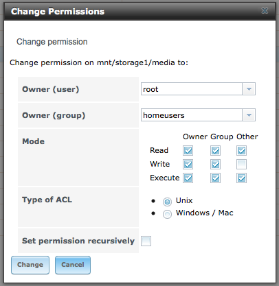

I've attached a shot of what my permissions look like on the volume/dataset. At the top level, I've set it with the same permission on the volume, and then set the same permissions down to the individual shares on the media share (movies, tv, music, etc). Instead of setting myself as the owner, I've set my group (home users) as the owner (group) setting since there are 2 of us who may be read/write files to the share. Realistically this is probably more open than some folks will do since I'm not specifically giving my user permission as the owner directly. I've then setup AFP sharing on the media share instead of each individual subdirectory, and set the @homeusers in allow and read/write fields. For default permissions on files/directories, I've enabled all 6 for Owner/Group, and left R-X on files, R on directory for Other.

I attempted briefly trying to switch over to Windows/Mac as the permission configuration, but was unsuccessful at getting this to work either. When I did it this way, I wasn't able to write to the shares anymore. Additionally, I was still seeing these funky issues appearing in the folders too.
Something is definitely whacked with your setup then since that should absolutely work. In fact, using the Windows/Mac ACLs is the proper way of doing permission control for AFP now. I think your desire for security settings may have led you down a blind alley or something since using straight-forward ownerships and ACLs works very well (or my own Mac wouldn't be able to talk to any of its shares or back up over Time Machine to the FreeNAS).
Try to simplify your setup until it works. For example, create a single dataset for sharing owned as you. Don't think in terms of folders, think in terms of zfs datasets and make sure to apply your permissions recursively. Don't try anything fancy with sharing, either. One share point per dataset, no subfolders or anything other than the base directory of the dataset.
