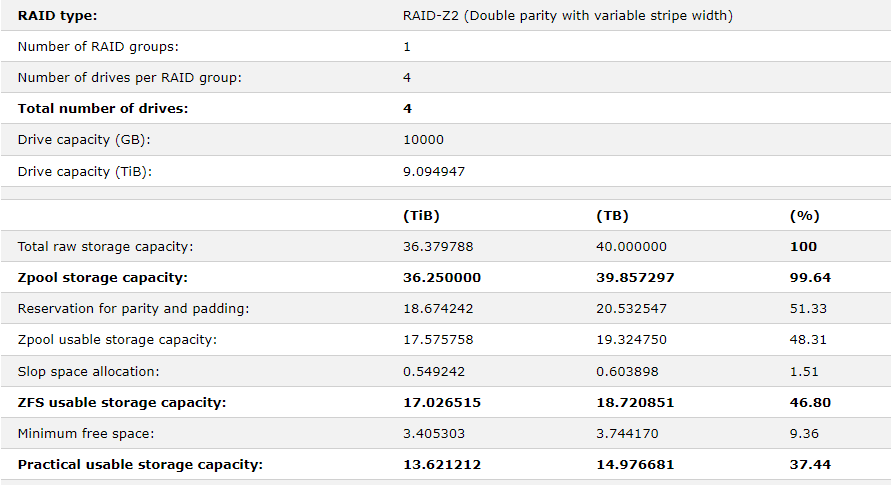

You may have a problem with usable storage space, which is around 15TB with your proposed configuration. What you could do instead is have 3 x 10TB in RAIDZ1 (15TB usable), then add another vdev of the same when needed. Don't forget you can also expand - i.e. start with 8TB and slowly replace them with 12TB if needed.
Or you could have 6 x 10TB RAIDZ2 to give you 30TB usable - reason for this suggestion is to give you 2 SATA ports available during the replacement of a drive.

Useful website for calculating usable storage space: https://wintelguy.com/zfs-calc.pl
No, 4*10 TB in RAIDZ2 will give roughly 20 TB. You basically loose 2 drives for parity with RAIDZ2.

Do note @ChrisRJ 's post, I was being pessimistic regarding RAIDZ2, it seems you don't have to worry about leaving 20% of unused space - it is strange that TrueNAS by default gives a warning to the user when >80% of the capacity is used though? I might contact the Wintelguy and advise him of the mathematical error on his website.
As I may be providing false information, it's likely sensible that I discontinue my contribution to this thread.
