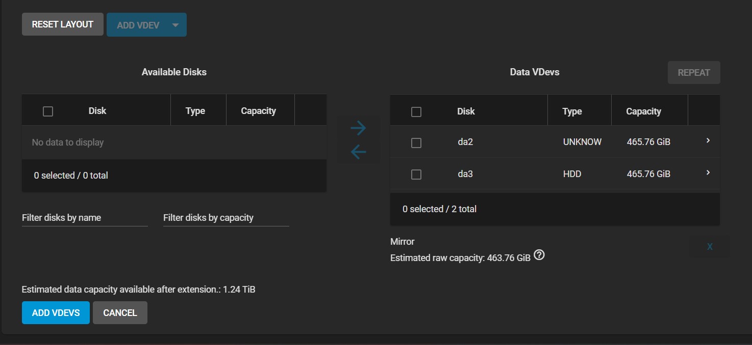

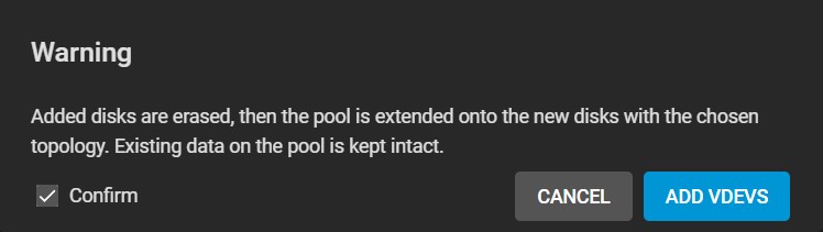

Once I Click on Add VDEVS and confirm, it will process for about half a second and then the error message comes up.

da2 showing up as UNKNOWN (rather than HDD or SSD) is strange.
Can we look into the smartctl -a for both drives?
Aug 14, 2023
5
When you mentioned that, I Swapped drives and noticed that one of the cables is not working properly, I am getting a replacement cable to see if that clears up the communication problem. I will post as soon as I receive the new cable.
Aug 14, 2023
5
Replaced the cable that had the communication issue. Everything works after replacement. No error! Thank you for helping me track it down.
