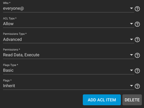

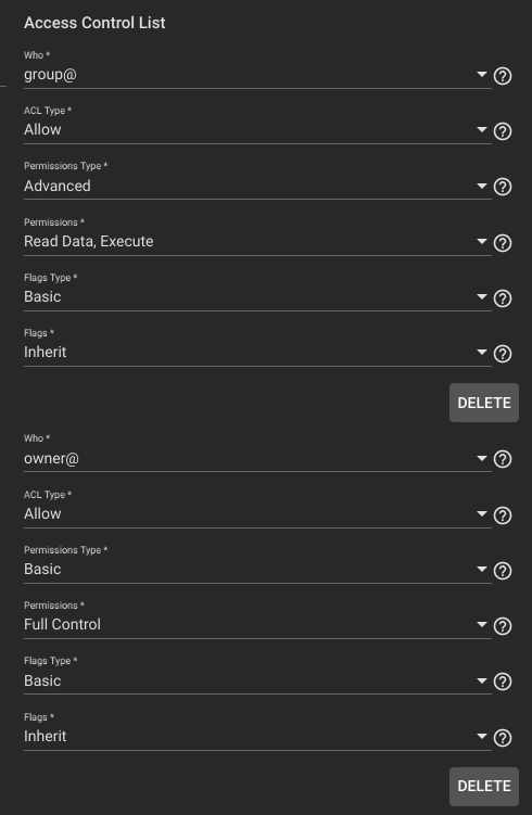

Hi, I configured a user that needs to access files stored in a SMB directory for read and execute only, also there's another user who need to RWX access.
User with all permissions is named "informemedico" and the read only user is "drcalderon".
drcalderon is part of the "informemedico" group.
informemedico's main group is also informemedico.
There is a pool named "imagenes" whit the following ACLs:
Now when I (as user informemedico) create a file inside a subdirectory of imagenes, the file is created with this attributes:
----r-x---+
But I would like to have drwxr-xr-x+.
If I call getfacl on that directory I get:
# file: .
# owner: informemedico
# group: informemedico
group@:r-x---a-R-c---:fdi---I:allow
everyone@:--------------:fdi---I:allow
owner@:rwxp--aARWcCos:-------:allow
group@:r-x---a-R-c--s:-------:allow
everyone@:r-x---a-R-c--s:-------:allow
What can I do to fix this mess?
leonardorame
Jun 30, 2018
106
Well, I removed the ACLs of subdirectories, now, when I create a file (with touch test.txt for example) it gets this permissions:
-rw-r--r-- 1 informemedico informemedico 0B Oct 3 16:50 test.txt
How can I define the parent ACL to newly created files have the x attribute?

Create the dataset as an SMB dataset (or set aclmode property to RESTRICTED). Do note that you should use the BASIC-READ permissions set rather than trying to hand-craft something. SMB clients need to be able to read attributes / stat files.

Alternatively, if for some reason you need a local process to be able to chmod(2) files, then you should define the permissions you need via an additional ACL entry for the group informemedico (or whoever is accessing the data).
